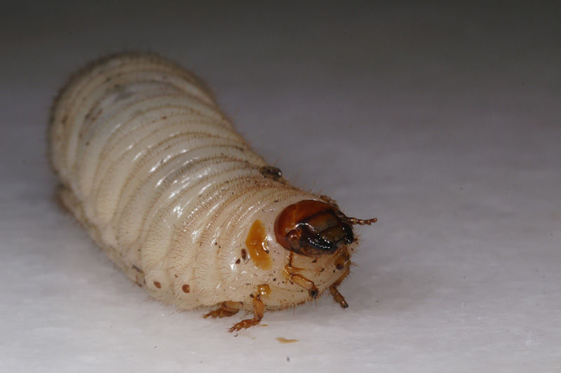

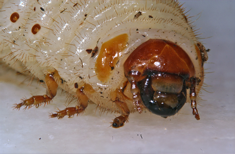

Have a look at this, ok the subject has to stay still and it is best with a tripod (but works hand held). Normally i wouldnt be able to get more than one or two segments in focus at once, but here got the whole thing. definate reccomendation from men (IMO better than Helicon Focus, that costs 100 odd $ a year.
7 pictures stacked
9 pictures stacked
and non processed at f22
the inset is a 100% non resized crop
Try it and see what you think
