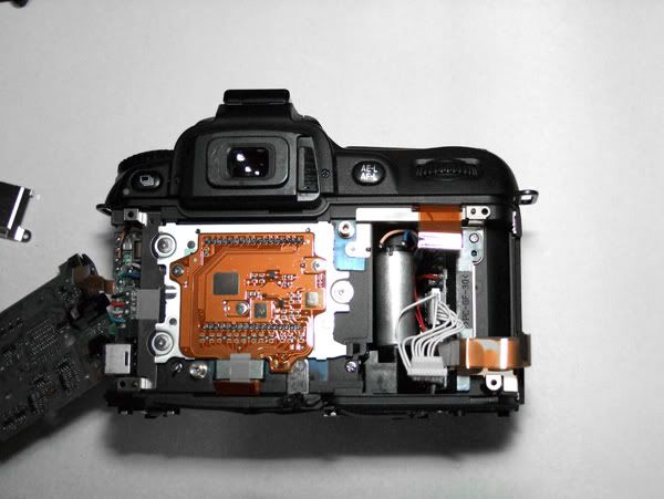

Converting my D50 into an Infra Red Camera
m2v
Feb 12, 2009
82
#1 got everything ready, the little dark thing on the lower left was the IR filter (720nm)

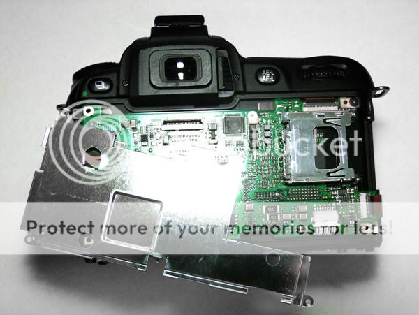

#2

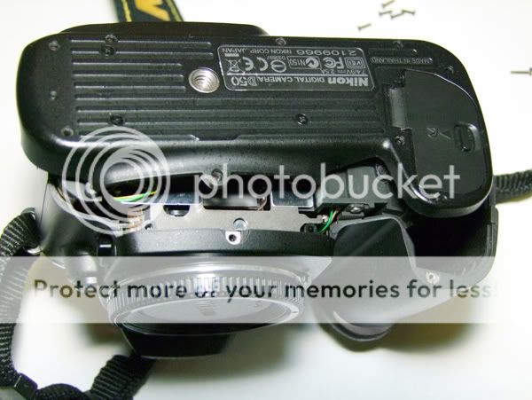

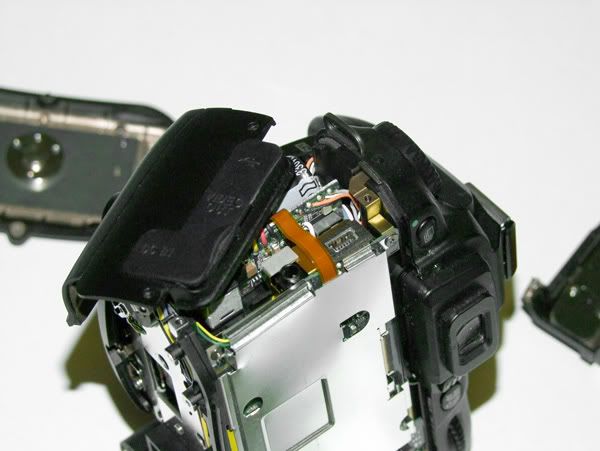

#3
#4
#5
#6
#7 this cover plate needs a soldering gun to remove

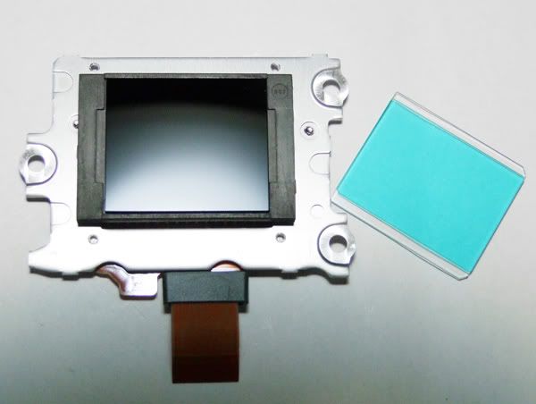

#10 now finally the CCD component
#11
#12 replace the original filter (the cyan color one) with the IR filter
