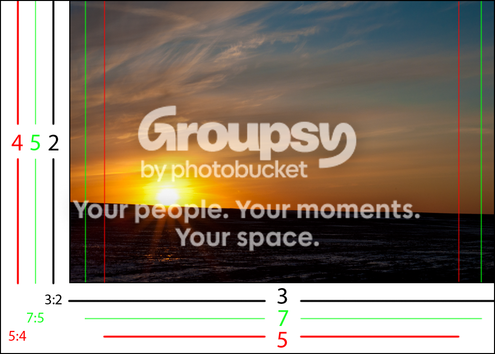

Well,i am not sure what your asking but if you need to print a 8X10, you will have to crop the orginal image to a 8X10. If you want to reprint that image in a 8.5X11 you will have to recrop it.
Common print sizes have different aspect ratios....so if you want to print a size that is different than that of your image, you will have to crop (or leave extra space).
This is not a new issue. Photographers and anyone making prints are making these decisions all the time.

It's really just a matter of division. 4x5, 8x10 and 16x20 all have the same result: 0.8 (or 1.25) when you divide one dimension of the print by the other. The two numbers are reciprocalhttp://en.wikipedia.org/wiki/Reciprocals of each other. That's about all you need to understand.
So if you want to crop an image for an 8x20, you simply adjust the crop lines and watch the aspect ratio. Once it says 0.8 or 1.25 and you're happy with the composition, you're there. If you want some other size, like 5x7, just divide the two numbers and use 0.71 and 1.4 instead. 11x14? 0.79 and 1.27.
If only people would embrace, rather than reject, math.
