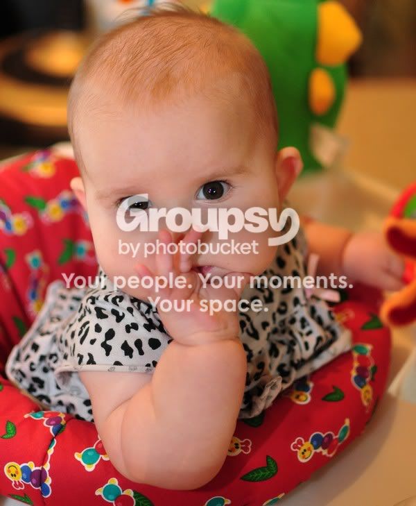

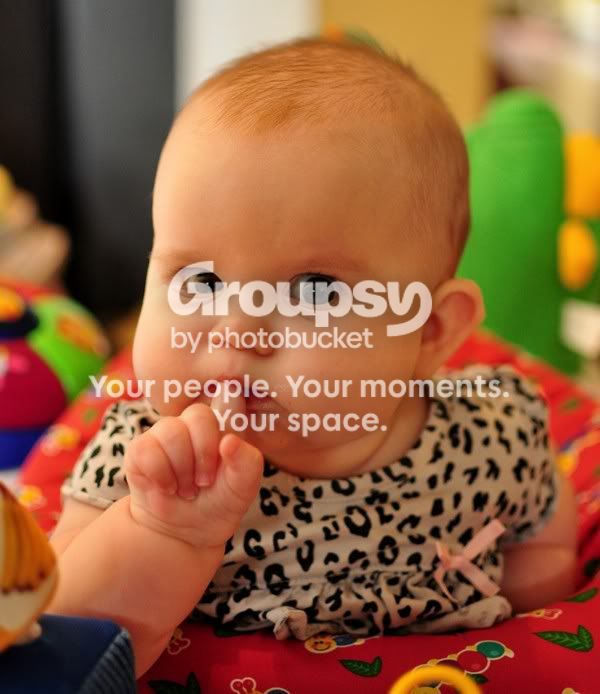

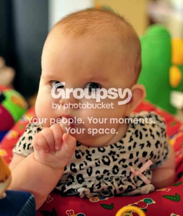

I am trying to learn lighting techniques and took these photos this past weekend with my new SB-700. I tried to bounce the light off of different surfaces and from different angles to avoid "flat lighting" and to get some shadows and 3-D effect to these.
Are these any good from a lighting standpoint, composition aside? There may be some clutter but if that can be put aside, are these still considered to be "flat" lighting? How can I improve them? Thanks.
1. I believe I turned the flash 90 degrees or more to the left and I am not certain if I elevated it at all.
2. I think this was 90 degrees to the left and no elevation.
3. Rotated 45+ degrees to the right and elevated 45+ degrees upward.

There is some side lighting on the (cute) subject, so in those terms, you'd doing well. However, all of the shots look underexposed and you have some serious White Balance issues.
The underexposure part should be easy to fix. Either let in more ambient light or turn up the FEC (flash exposure compensation).
The white balance issue might be easy as well. The EXIF data shows that you had it set to cloudy, but you are shooting with flash and have indoor lighting affecting the scene as well. If the white balance had been set for the flash, the light from the flash would likely have given you good skin tones, but the ambient light would still have given you a color cast. If you had set for the indoor lighting, then the flash's exposure would be off. That's the problem, you can only be set to a single WB setting (even if it's a custom WB setting), so it's best to avoid situations where you have such different light sources.
Of course, people use flash indoors all the time. So in that situation it's best to pick one light to be your main source and use the other sparingly. For example, if you had made the shutter speed faster (and/or used a smaller aperture lower ISO), you could cut down on the amount of indoor/ambient light in the photo. The flash will pick up the slack and give you more (especially if you dial in the FEC). This could allows the flash exposure to 'overpower' the ambient...and so you can use flash (or auto) WB, and probably get nice skin tones.

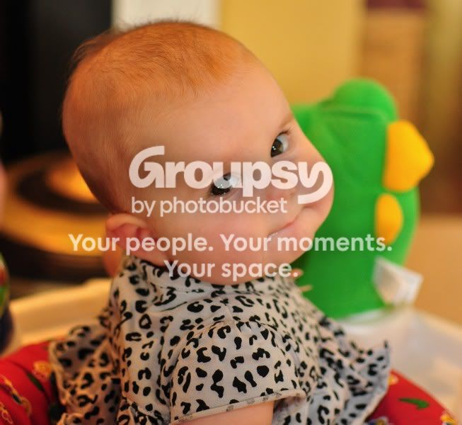

I've adjusted the color in the second shot. Does this look better? Thanks.
In the picture above her skin tone was too red. I've increased the contrast and decreased the level of red.
It's better, but it still look a little to red/yellow (on my screen). The flashed side of her face, looks especially yellow.
That's the problem with multiple light sources, you try to correct for one color/source, but then the others will be out of whack.
