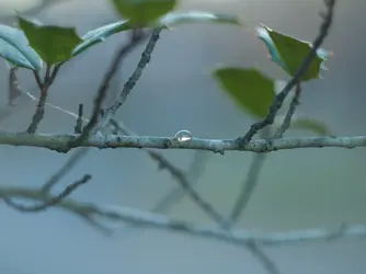

My Helios 44-2 wide-open at F2, on the Olympus EP-2.
