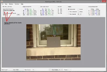

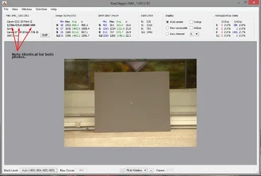

Here's screen shots of my two test frames in RawDigger.
Joe

Please post image files with exif intact.

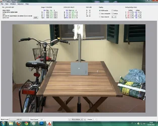

Guys,
here is the snapshots of RawDigger. The second shot is not at completely wide angle to not have the gray card too small.
1/50s f5.6 ISO200 - R=307, G=500, B=300
1/50s f5.6 ISO200 - R=226, G=365, B=221
You clearly have two different exposures there. I would think the suspect variable is the lens f/stop. ISO and shutter speed are very unlikely to be changing between the two exposures. You're using a variable aperture zoom of nominal quality and from the manufacturer's point of view a discrepancy of this degree is going to be completely smoothed over by software so what's the big deal anyway. It falls into their acceptable tolerance range. Get a Nikon lens with a gold ring around the front and you'll probably see less of a difference.
Try the test at a smaller f/stop like f/8 or f/11 and odds are the discrepancy will be less. But I'd say you're looking at a real hardware/physical difference in your lens that you can't alter. I wouldn't let it bother you too much. It is a zoom lens after all.
