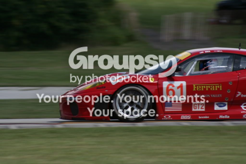

First attempt at Panning... What am I doing wrong?

That's what I was doing. I'm pretty sure I set the aperature too wide. Going to the track again on Sunday so I'll try again.
You did not have it wide it was at F22 1/125 for first shot
Thats what I was saying, the supra was taken at f/22 1/100 sec....
Actually he might be able to open his aperture a bit to f/8 - f/16 to hit his lens' sharpest aperture...but mostly its the pan.
Looking again i think the OP may have had a bit of up and down movement ?

That's kind of what I'm seeing. I think your tips about keeping the elbows in and a smooth press of the shutter would help a lot in this case.
