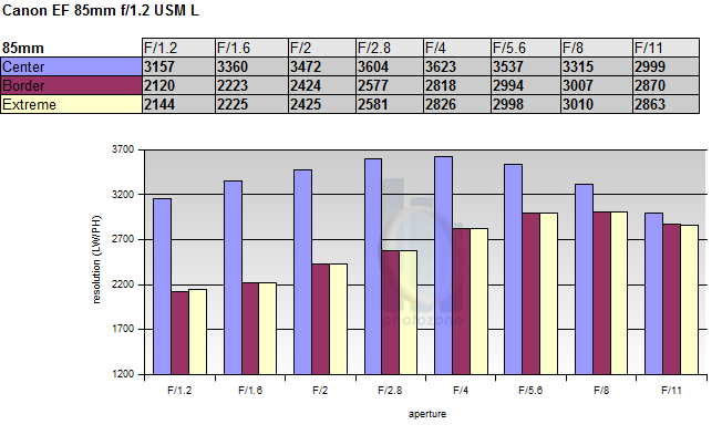

From photozone.de:
Looks like you'll have pretty good sharpness all the way up to f/8. The centers and borders are the only areas you need to be concerned with as you have an APS-C camera. It could be that your lens has front or back focusing issues, but I'd rule out user error prior to that.
Very interesting table! So, if i shot at 1/500 with a higher ISO, it shold've been able to produce a sharper image you think? Even if the f.stop was at 2 or 5.
