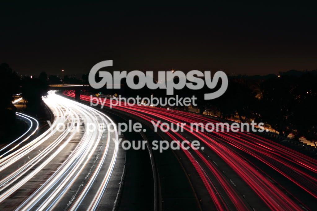

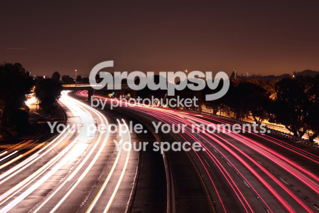

Freeway shot from bridge, Practicing Shutter Speeds.

The first image looks good. I would have turned the camera a bit to the left, but that's just me. I can't get the second image to load.
what were your settings? I like #1
not a bad start. yup messing with the shutter speed and taking long exposure shots of highways can be quite fun
nice pictures. you caught an airplane up in the sky
Shot 1: Auto exposure, 32 sec, f/18, ISO 100, Compensation: +7/3
Shot 2: Auto exposure, 12.3 sec, f/6.3, ISO 100, Compensation: +4/3
OP, shot 1 turned out much better than shot 2. Keep in mind that aperture is the opening of the lens diaphragm. Closed down to f/ 18, the light hits the sensor at a much more stinted rate which is good for this kind of photography. When you shot at f/6.3 there were brighter areas and not as much definition in the light trails. I'd shoot on f/11 or smaller for these kind of shots to yield a good result. If I remember correctly the T2i either has a custom function, or can go to ISO 50 by default. Find out which it is, and keep in mind that you can use ISO 50 to get you a longer shutter speed than you would at f/18 because it is less sensitive to light than at ISO 100.

By f/11 you'll already be taking a hit in sharpness, so I wouldn't want to go much past that. Diffraction limit for 550D is about f/11.3 if I remember correctly, and your lens will be getting a good deal softer by then too.
If you want it long have a look at picking up a ND filter.
