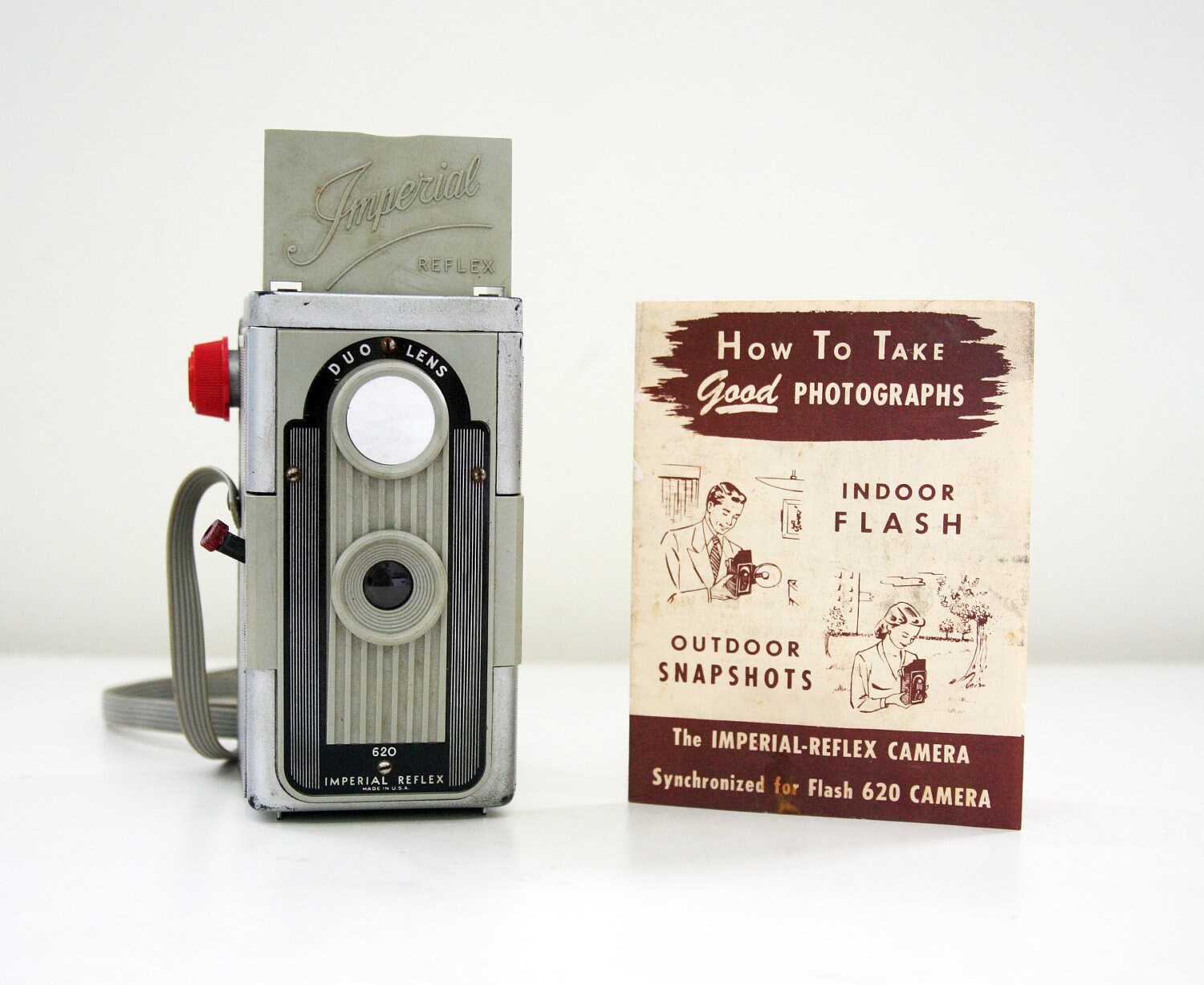

We were playing with this camera last weekend, not really knowing how much to turn the knob of the film advance.
Looks like it needs 2 full turns to advance each frame.
Overall, I'm pretty impressed with this little TLR.
http://img3.etsystatic.com/004/0/6996302/il_fullxfull.385501131_g15j.jpg

Looks like a fun. Surprisingly good lens, little low on contrast, but despite fix focus pictures look quite sharp.
But that is an "infamous" camera, Lee Harvey Oswald had one. We know it, as he didn't "hide" his face :lol:
Herco/Herbert George made some cool looking midcentury modern cameras - I like this one! It might actually be a viewfinder; many of these were styled to look like TLRs but didn't actually have the twin lenses - the image being projected onto the film is coming thru the same lens as what's being viewed.
Are you able to read the numbers well enough thru the red window? Did you use 120 or 620 film? - with the spools being slightly different in size it can make a difference in the film advancing and wrapping around the spool.
When I load cameras similar to this I usually allow extra film and paper at the start - I try to make sure it's catching and advancing and laying flat before closing the camera. I keep turning and make sure the tension feels taut enough but not too tight or pulling, but more often I find there can be more of a problem with it being too loose. I often end up advancing to #2 to start shooting but I'd rather loose a frame at one end than lose a whole roll (which I've had happen...). Hope you keep enjoying your camera.

Couldn't see through the red window, no. :)
It was 120 re-spooled on a 620 spool.
