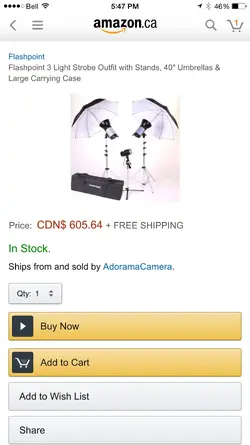

Might want to mention the inexpensive Adorama Flashpoints Strobes and Kits, such as ==> Flashpoint 3 LS
I have 4 or 5 speedlights. I wish after 1 speedlight (needed for roving camera) that I bought Strobes instead.

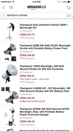

I found the lights mentioned on Amazon. I have been on the fence about monolights, decided to go speedlight out of economics and the fact I HATE my canon speedlight.
Would these little slave flashes fit the bill?

I would like to keep my setup portable for the time being, and less expensive. Im wondering if the little slave strobes will be good for rim/background/key/hair lights. I only need 6 lights. I can add more YN560s for about 100$
I figure if I can set it up fast in my living room then I can take it with me to do on location work. I do food photography for my day job ( Chef).
Darrel can you explain what you meant by " shooting blind with them... everything is after the fact", and the main reasoning to go with moonlights over more speed lights, and if there is a useful, cheaper option
I remember reading a post of Braineaks about a car. Ugly little car but cool lighting haha.
Shooting Blind: Using speedlights with studio modifiers (umbrellas, grids,softboxes, diffusers,etc) is shooting blind....meaning you can not literally SEE what each flash is doing...you can not actually SEE reflections, catchlights, shadows, glares, or anything that the light is actually doing in real time. Has the subject slumped a little bit, and one eye lost the catchlight? Is the subject in the good light...what if the subject moves in relation to the lights...what if the camera is moved in relation to the subject?
With real studio flash units, the eyes of the subject close down, and show color....in a darkened room with speedlights, the pupils of the eyes open up wide, eliminating eye coloration, and giving that OD'd on heroin look. When you are using real studio lighting, you can literally SEE good, better,best positioning of the subject for every second...you can move the subject, or move the light, or move the camera, and at ALL times, you can literally SEE what each light is doing, on a real-time basis.
Shooting with speedlights, every single aspect of lighting is only visible AFTER each single exposure is made. So, you're a chef! The small slaves are wide-beam, not easily controlled, and must be in household-base type light fixtures. For USA buyers, the Flashpoint 320M is $99...less expensive than a good speedlight from a reputable maker, and 3.5 to 5 times less costly than a high-end camera-maker speedlight.
