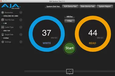

I just did a test on the memory card and it's only writing at 37 mbps but it's advertise to write at 80 mbps...
so that's probably the problem...
My problem is that I'm now in central america in a remote place where it's not easy to find a U3 memory card... I hope I can find it.
i just put a different memory card and the camera is working fine now... i think the problem was that the card was a micro sdxc with an adapter
