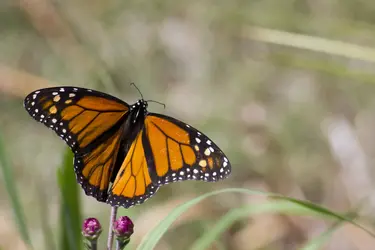

I don't do a ton of macro, but it's not because of a lack of ability to get clean focus. I can and have gotten clean focus just fine from rocking back and forth, even at significantly sub-1:1 distances. For example these were both focused entirely by rocking, despite being maybe 0.15-0.2 (?) reproduction ratio, tops:
View attachment 48821View attachment 48822
In fact, I often rock back and forth to refocus subjects at 3-20 feet away! Especially when composing subjects off center, and doing a "center and recompose" strategy. Since turning the camera tilts the focus plane, I often lean back by an estimated correct amount right after pivoting, to compensate and bring the subject back into focus without having to fiddle with anything, even with AF on. Example of a portrait that I did final focusing on by calculated leaning away only, from 10 feet or so, at a reproduction ratio of about, i dunno, 0.03??
And rocking only becomes more and more practical at higher ratios than these.
If it is less than 1:1, it is not macro... if it is 1:1 (LIFESIZE!) or greater, it is macro. If it is significantly greater than 1:1, than it moves into Micro.... (oh.... and feel free to check other dictionaries on the definition.. majority states image is same or larger than lifesize, as in MACRO!) ;)
So I take it you have no Macro shots to post... just butterflies from a distance? Considering the size of a Monarch butterfly... those are not Macro (as you mentioned!).. just insect shots! Why rock? Why not just focus and shoot? MF or AF? At distance, AF would work fine.... These are not even that sharp!
And I guess I am missing your point about the Horizontal Portrait... if you have to rock on longer distance images... I would suggest trying to correctly learn to use a focus ring / AF.
