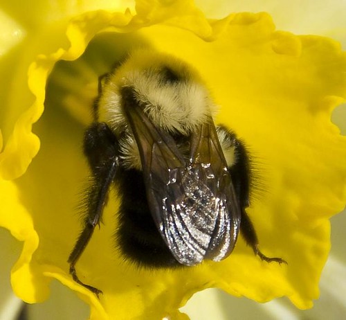

This is a crop from a photo I took this morning. The bug was about 1/4" long. I didn't use any extention tubes when taking this.
Wow...thank you so much for sharing! That is really a great picture. Hope one day I'll figure all this out so I can take some better shots.
