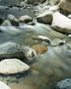

My NDF is giving me unwanted special effects :chuncky: It works fine, then it produces a moire, then it works as it should again. Examples are attached.

In successive shots with no other changes made?
You're dialing down your VND too far. Back it off some. That'll take care of the Dreaded VND 'X'.
But the moire was only reduced at the lighter settings and at other times, it goes perfectly down to total black with no problem. Look at the sky in this one...

I can't say no other changes. You have to dial it up to see the shot then turn it back down. Most shots are taken at a similar shutter and f/stop.

That's normal for VNDs.

Bottom-of-the-barrel VNDs will start to X out at 5-6stops, while top-shelf filters can go to 7 or 8 before they do so.

TestPos.webp This one is set nearly to maximum and no X. That's the dilemma. It doesn't happen every time.
