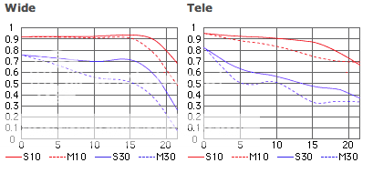

Take a look at this MTF chart, and tell me what you thin k about the performance at the short end...
Sigma unveils 120-300 f/2.8 EX OS - Page 61 - Canon Digital Photography Forums

As for standing up to the 70-200/2.8II, I don't think it really does. See the MTFs below. Although, it is said to use very well with the 2x TC. See the MTFs below.
Sigma unveils 120-300 f/2.8 EX OS - Page 61 - Canon Digital Photography Forums Honestly, it's better than my 80-200/2.8D now. It may be as perfect as the 70-200/2.8, but it's quite alot better than my 80-200/2.8, and gives the extra reach I'll need.
