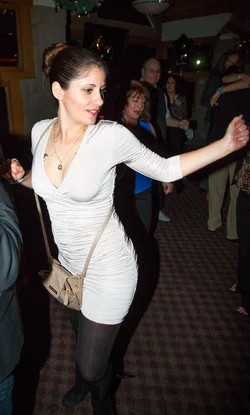

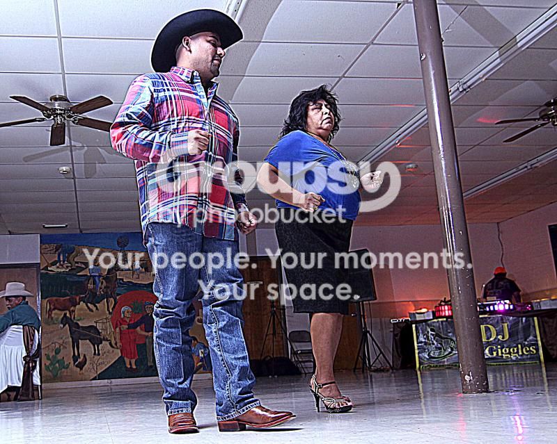

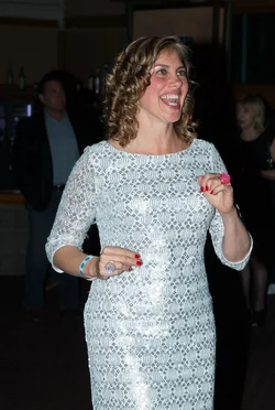

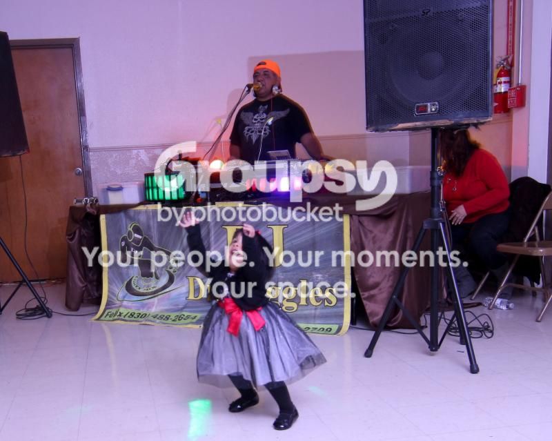

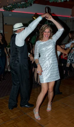

Not so great images. What can I do to make these images better?

You're using direct flash. Most of the photos have a strong shadow cast right behind the subject.
You would want to bounce the flash off the ceiling for a more natural look. Do you have a speedlight or was that the on-board flash?
I tried but the ceiling is too high. It has no effect.
Editing wise you could remove the retinal reflections and try cropping in on a few of them.
They don't all have to be full body shots. I think some of these may work better as heads and shoulders shots. You have the resolution, use it :)
You're shooting at ISO 100 and at your sync speed of 1/250th.
I would start by raising the ISO and shooting at a slower speed, say ISO 800 and 1/60th. This will give a much better sense of the ambient light and mood of the event. Since the ceiling is out of reach you will want to get your light source higher up so the shadows are being cast down behind the subject not directly behind them. It would also be of benefit to increase the size of the light source (This is one of the major benefits of bouncing, the whole ceiling is a light source) even if you're just using an Index Card or piece of paper strapped to your flash.

Try to get shots of individuals or small groups in closer, or scenes with some people dancing, or maybe a few at tables, etc. You don't want people chopped off (look at the sides of your photos) - either get them in the frame and in the photo or out of the frame and out of your picture (or when you crop them down think about where to crop). You need to get people's feet in the frame too.
Keep distractions out of the frame (#7 & 8 lower right), objects or edges of objects and people that don't need to be there, that aren't part of the scene or adding to the picture.
