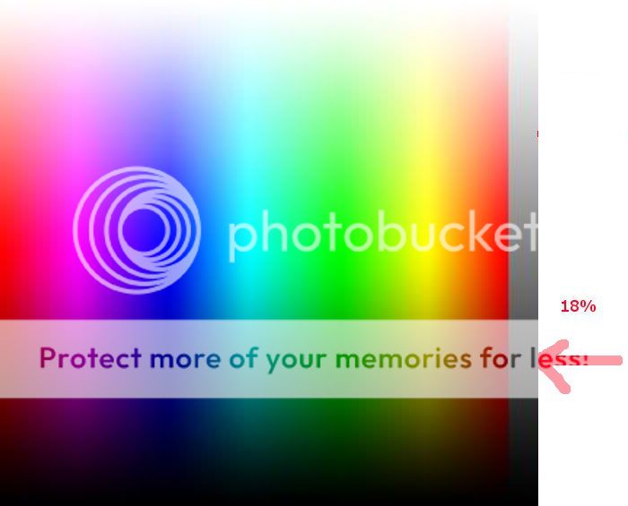

The answer to the quote in BOLD is "No". When taking a picture. An 18% gray card reflects 18% of the light that hits it.... The amout of reflected light dosen't affect the color. The color only has to do with the wavelength of light.
Look at this color chart as an example. Every thing on the top reflects 100%, every thing on the bottom reflects 0%. If you draw a horizontal line anywhere on this chart, the %age of reflectivity for any color under that line is exactly the same. So if you draw a line from where I have 18% marked, there is a shade of every color... red, blue, yellow, green..etc that reflects 18% of the light.

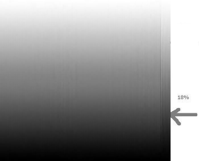

To prove this, simply desaturate (remove the color) from the image leaving only its brightness behind. You can clearly see that if you remove the color, the amount of light (brightness) is constant across a horizontal plane.
As you can see, the 18% gray part is really only important to exposure and metering... That is its primary purpose... to measure HOW MUCH light is entering the camera. But since its already in your camera bag, it also doubles as a reference point for white balance and camera manfactures give you the ability to adjust your white balance off of that gray card.
