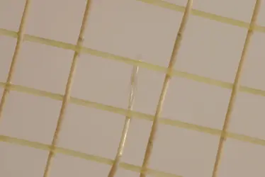

Sample: ISO400 f/8 1/4s
Add a sample: ISO400 f/5.6 1/4s

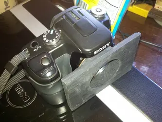

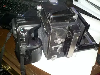

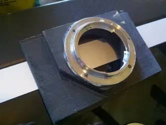

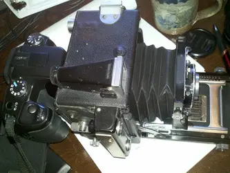

Here's a digital macro solution I came up with using a miniature speed graphic camera and a lens mount from an old Minolta auto focus lens. I really should mount an enlarging lens to the camera to test it out. I'm not sure the regular 101mm lens on the camera should be used for macro work. These pics were taken with my cell phone.$Adapter 1.webp$adapter 2.webp$adapter 3.webp$adapter 4.webp
