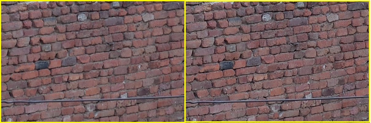

Cropped section of the wall in the third file. Unsharpened on the left, some output sharpening on the right. Otherwise they are the same image. The difference is pretty obvious.
The vast majority of Raw file type images need to be sharpened.
Most Raw converter software does little or no image sharpening.
Post process image sharpening is involved enough that an entire book has been written to cover the subject.
This book was written by the guys that wrote Lightroom's Sharpening and Noise Reduction software: Real World Image Sharpening with Adobe Photoshop, Camera Raw, and Lightroom
In fact they recommend sharpening be done in 3 stages - 1. Capture sharpening/noise reduction in Camera Raw/Develop module.
2. Local sharpening in Photoshop using the wider range of sharpening tools and techniques available in Photoshop.
3. Output sharpening based on intended image use. Images destined for print can usually can be sharpened a bit more than images destined for electronic display.
