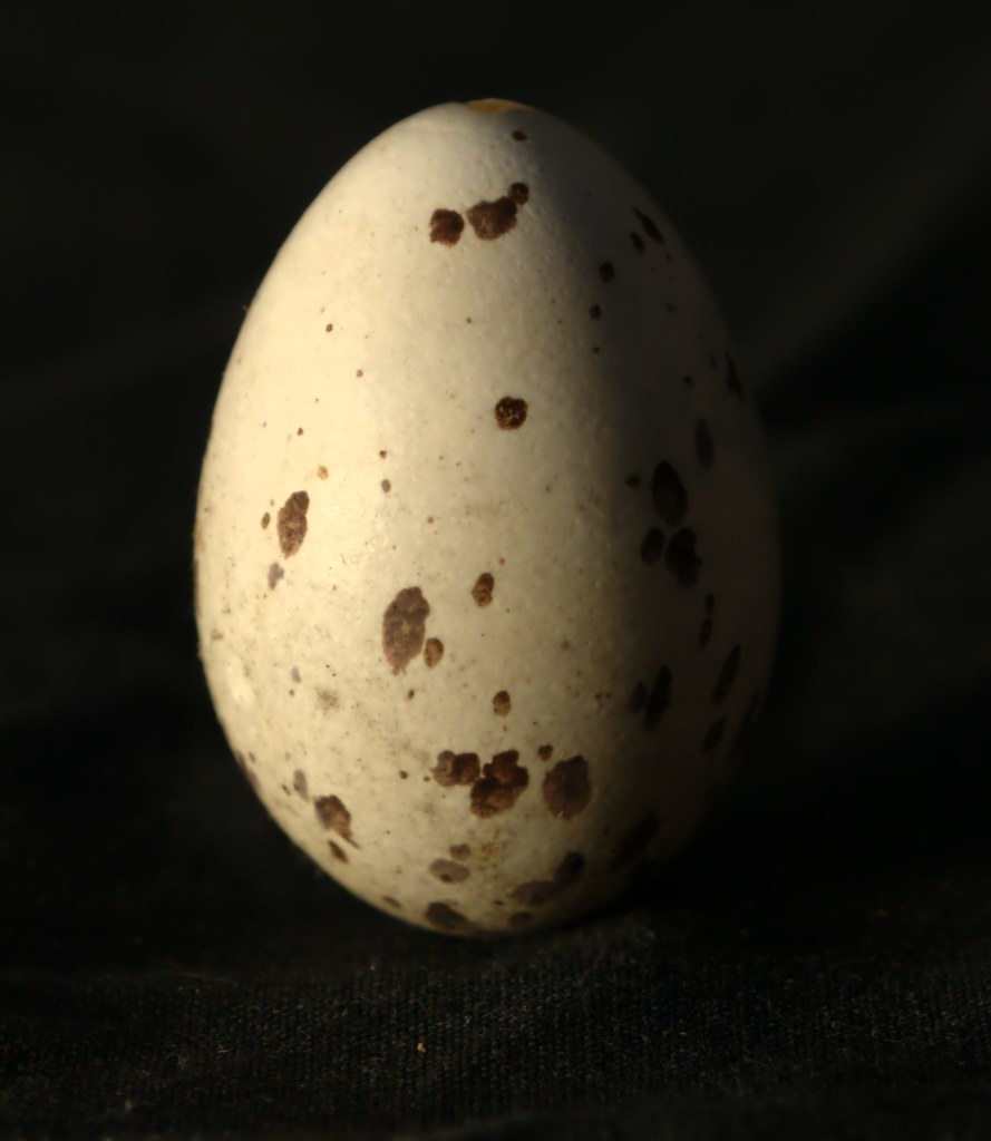

Greetings all. I'm having problems with sharpness, and I'm pretty much 100% sure it's me. I'm wondering if there is any trick to this. I'm working with an egg collection from the early 1900s. (And, yes, for you environmentalists, this is legal since they were collected pre Migratory Bird Treaty Act according to the FWS.) I'm not thinking about composition at all at this point; composition means nothing if you can't focus the camera. I'm aware I should have probably been at f/16 or something instead of f/8.
I'm on manual focus (auto is not as acurate as my eye), VR off, tripod, using auto timer to fire off. The only other thing I could really do is lock the mirror up. These are taken at ISO 100 with the 18-55 5.6 VR kit lens at 55mm. EXIF data should be there and on flickr. (Click originals for link to EXIF.)
Too soft for my liking:

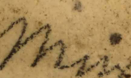

A 100% crop of that photo:

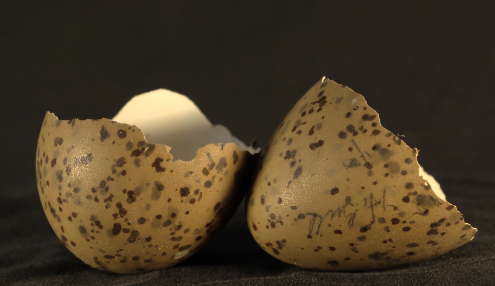

Now this one came out pretty good. I want to learn to reproduce this:

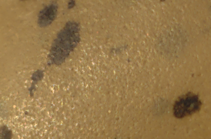

100% crop:

I've got 6-8" of closer focus, so unless it gets less sharp as it gets closer to it's minimum focus distance, that shouldn't be a problem.

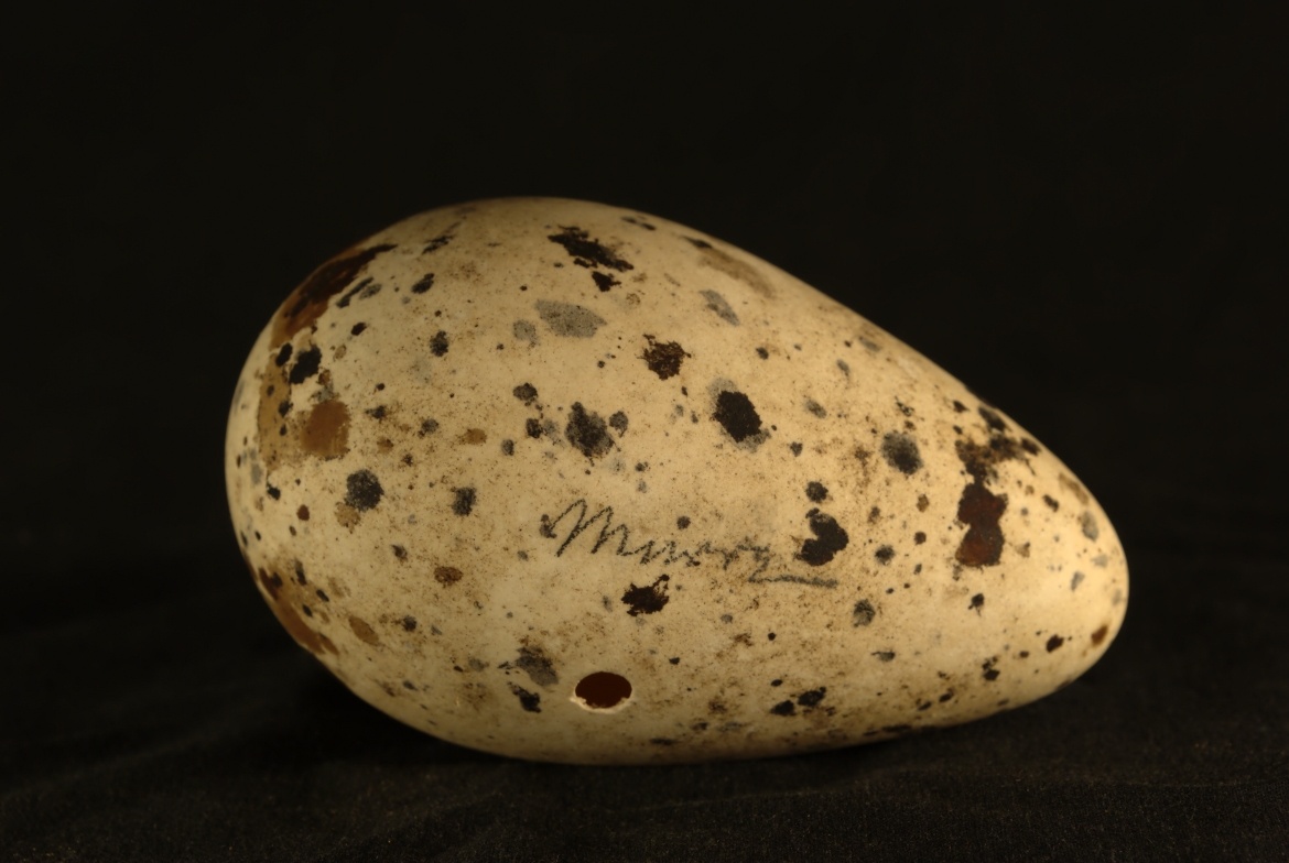

Here's one with auto focus, no VR, f/11.

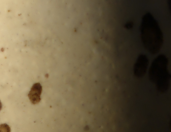

100% crop:

The first one is not too soft at all. At least that portion that's in focus.
If you carefully examine the black fabric/carpet just below and in front of the egg you will see an area that's quite sharp. Its seems you misfocused. Best focus is in front of the egg.

Maybe it's just me but the last one you posted of the egg in auto seems the sharpest... I like it though. I guess it depends on your preference.

It's also 3x the size of the other two.

I think Dwig nailed it in that your focus point is in front of the egg, not on the egg in the first image.
