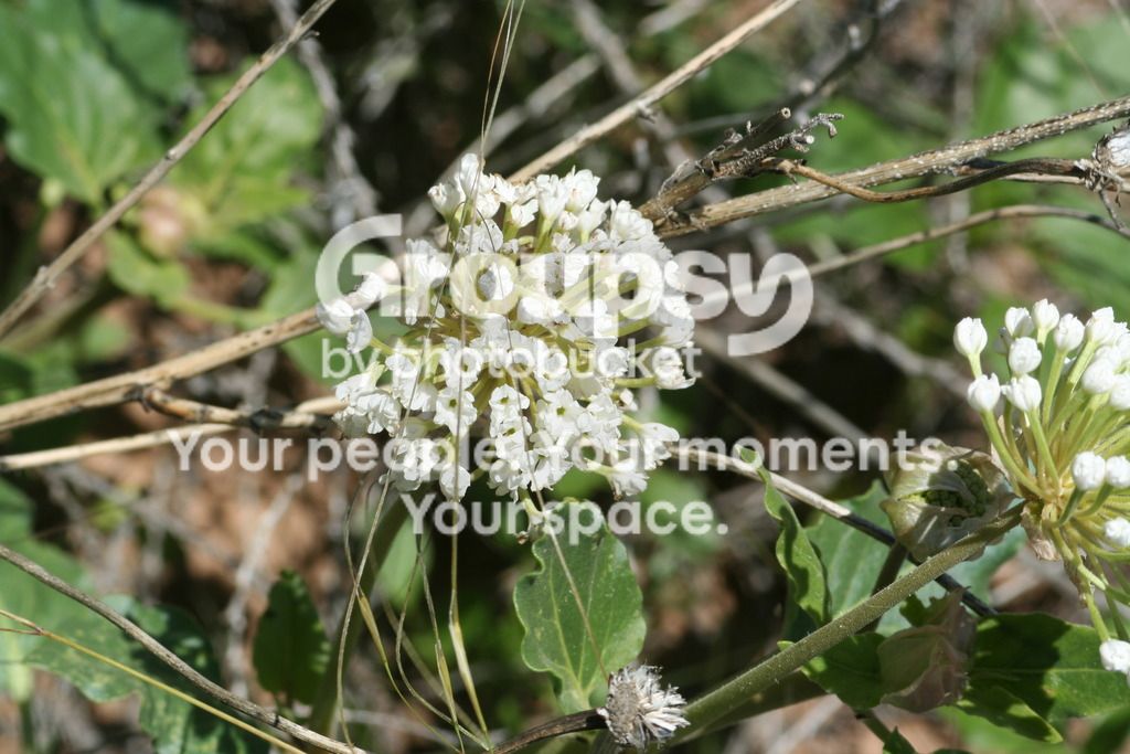

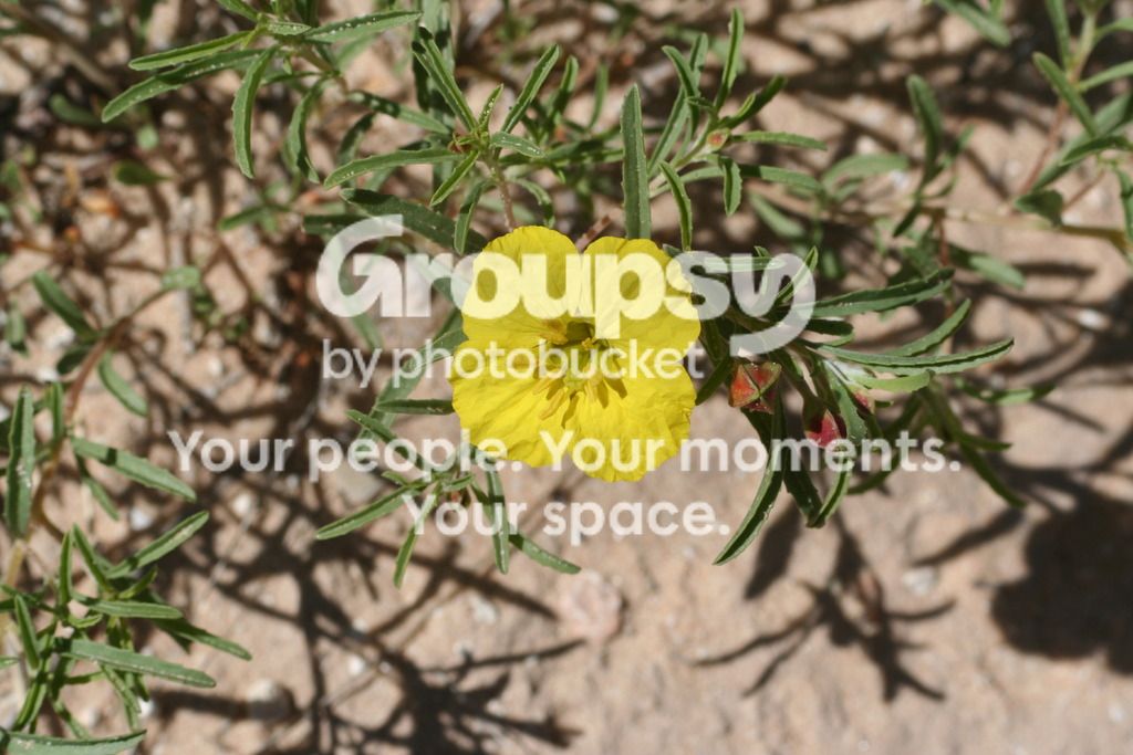

While the light level the OP stated is unusually high as it's about a stop brighter than sunny 16 but it's not the light level is the problem. With an ISO of 100 most camera should be able to expose correctly. Without a sample pic I guess that the light is really harsh and contrasty.
Not the best photos, but the most decent examples I can get from my phone at work.
