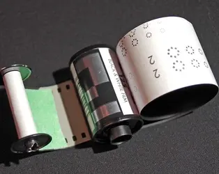

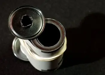

Now, in the dark, spool out the film to the end of the backing paper cut at the 9 of 12 frame. Any longer might bind, those spools are small and originally made for 8 exposures anyway. Carefully roll it up nice and snug, and place everything in the camera like so, Feel around to check that all's well then close the back.
Best to unload in the dark too. although the film advances smoothly, it doesn't stay snug on the takeup spool.

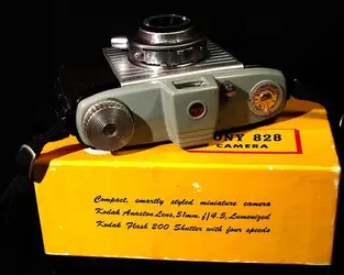

The Pony is a lovable little critter and was most likely the choice for serious amatures on a budget throughout the 50's to early 60's. Describing it in one word, well, friendly. Some concentration is needed to remember to wind on the film, cock the shutter and mind focus and exposure settings, all that manual stuff that we have all too soon become unfamiliar with. This one and the 35 mm model do their thing well.

Post must have been too big, anyway it was a bit long winded. Only the last 5 with discriptions posted. There was a brief writeup on the camera to accompany the pix shown as thumbs as well as how I cut 120 backing paper to fit.
My very first adjustable camera was a used Kodak Pony 135 B. As I understand, it was made from 1950 to 1953. I bought mine used for $16.95 back in 1975 when I was 12 years old. I remember the collapsible 51 mm F / 4.5 Kodak "Anaston" lens, the cell focusing, and shutter cocking which was not coupled to the film advance, which made you very conscientious(paranoid about double exposures might be a better way to describe it )about cocking the shutter and winding to a new frame. The Pony was a learning camera for me... within a few years I had an Argus C3, which had a rangefinder, but it as well had separate winding of the film and cocking of the shutter...
Have a Pony 35 B as well, all same as the 828 except film transport. I bought the 828 from the daughter of the hardware store owner that sold these in the 50's. Their price sticker is on the box. Here's the 35 model B post. You sent some pictures taken with yours. Pony = Rides
