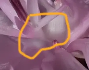

Even with a 40 stack image, there appears to be an area of OOF right in the center. I suspect what your missing here is that DOF is a function of aperture, distance to subject AND focal length. For example, comparing a popular brand combination at a minimum focus distance of 12" at f/5 a 35mm lens has a DOF of .51 inch, while a 100mm lens at the same settings only has .05 inch. moving to a distance of 36" with same settings, the 35mm has a DOF of 4.97 inches while the 100mm is only .56 inch. Shifting to a 200 mm which I've done at times you'd need to be at 69" from the subject to equal the same DOF as the 35mm at 12".

The OOF area you are referring to is a shadow from the side lighting.
Not referring to shadow, but the small OOF area in the center of the flower toward bottom left. Not overly visible till you blow it up, but it's there.
