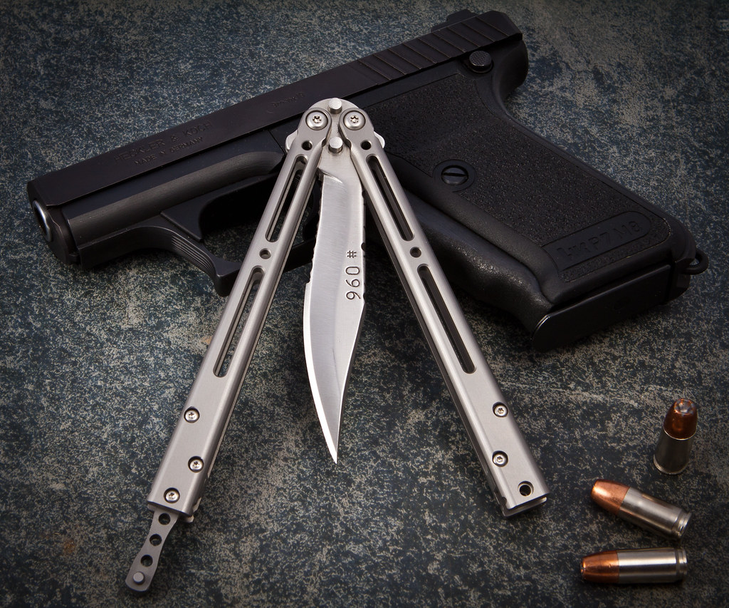

trying my hand at knife photography... critique and advice welcome

The grey background is much better than the green. My suggestions are to go to your local Lowes or Home Depot and get some 12x12" ceramic floor tiles for the background. They're not that expensive and will give you some reflective properties on the knives. Next I would try to get some distance between the knife and the background. Even an inch or three will help, but you'll have to watch the quality of the shadows...... subtle is the watchword here. Enough to create a visual anchor, but light enough to avoid harsh, sharp edged ones at the same time. This lift from the background can be anything that doesn't throw a color cast, think clear plastic spindles and blue tack. If you choose a profile shot, fishing line works wonders, just place the background vertically. Clip out the fishing line in post processing.
For getting the entire product in focus, obviously you'll want to stop down your lens. I'm thinking the f/8 to f/16 range (will require the appropriate increase in luminance). Other options are to focus stack (front to back in oblique shots) and merge in post or using a focusing rail and again merge in post (tip to hilt in straight on shots).
I noticed the various backgrounds in the Darrel Ralph site the Derrel linked. Makes a difference.
From what i've learned you want you're "product" to stand out more. A solid color background would be better in helping the product(since this seems to fall under product photography) pop out. Try using a solid dark kind of color. I'd suggest black or a dark sage. Maybe even navy blue. Maybe you could even try a 10-30 degree angle. But the above shots are nice.
Hope this helps. :)
That version with the gray background is now the type of photo that would help sell that knife, great job!

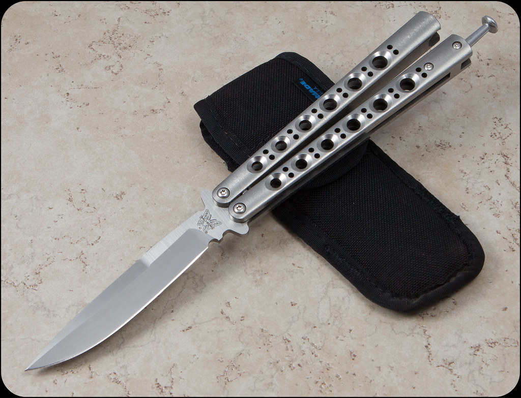

Experimenting with different backgrounds. This one is actually going up for sale.
Canon 50d with EF 28-70 L @38mm
f/11 @ 1/4sec, iso 100
lightbox with 2 side 65w lamps

I loved the pics, and thought the background just fine... My eye was instantly drawn to the knife, to drink in the details, and the back-round was only that. But then again, I am a knife guy, and think few things more pleasing than a well-polished piece of good steel.
