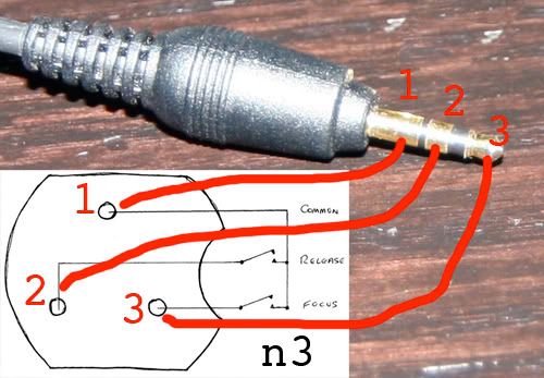

the hole on the 40D isn't just bigger, its a totally different jack. its an N3 input. my issue isn't the 1/8 to 2.5, it has nothing to do with that. i need something that looks like this:
im going to have to custom make it

Radio shack wont have the connector that plugs into the 40D, I think that is a Canon proprietary plug. For the same price as an end, you could always just get a new remote for the 40D here:
[ame]http://www.amazon.com/gp/product/B000NVX7EC[/ame]
