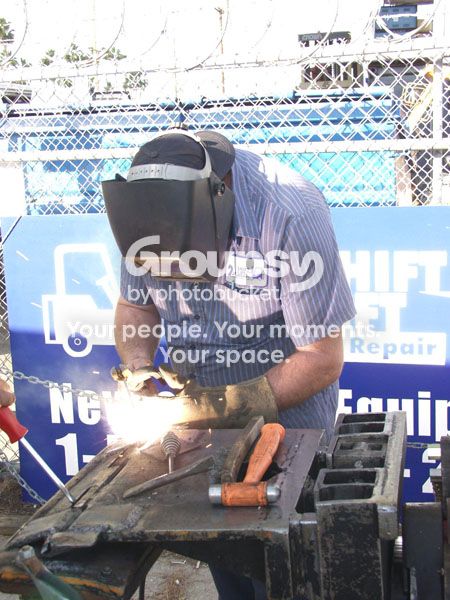

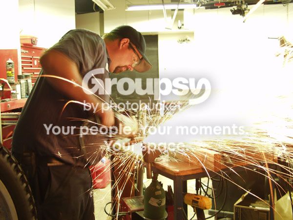

I've shot welding pics for my company brochures, trade show booth, etc. I'm not sure what conditions you'll be shooting in (bright or dark lighting) but no matter what, I'm going to caution you STRONGLY. Do not look at the light as the person is welding. It literally can burn your eyes and make you blind. Best way to do it is set up your shot prior to them starting the weld and when you hear them start the arch, start shooting with your eyes closed. I know that sounds strange but it's really necessary to protect your eyesight. Nothing too fancy but here are a couple of examples. The flame is extremely hot and bright. (the bright spots on the welder's shirt is from the torch, not sunlight) Shorter exposures will likely be the norm unless you're going for a "welding trail" effect. (Never tried that before :lol: ) If you have the chance, get some shots of them grinding the metal in preparation of welding. You can get some nice dramatic effects from the spray of sparks. Just make sure you're out of the firing range. :mrgreen:
Grinding
Shot with Olympus E20-N 11mm, f2, 1/2 second hand held with fill flash.
Welding
Shot with Olympus E20-N 13mm, f3.6, 1/125 second hand held in broad daylight.

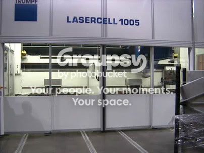

This is the advance shot they sent me.
I've done the grinding shot before. Cool sparks.
I suppose my main concern is: Will I be able to shoot at f32 and not be overexposed?

It's going to be a balancing act. I'm guessing that they want to show their welder off - not necessarily the flame. To expose the weld properly, the machine will likely be really dark or black. To expose the machine properly, the welding action will be overexposed. I would bracket all over the place using a tripod and merge the 2 best images in PS to end up with a pring that properly exposes the weld AND the machine. Just my 2 cents. You'll know more when you find out exactly what the customer is looking for. In addition, I would try for a shot with a wide angle lens from in front of that shelf on the right of the photo you posted with both welders going at the same time. Might be cool. :D Good luck Pete! :hugs:
