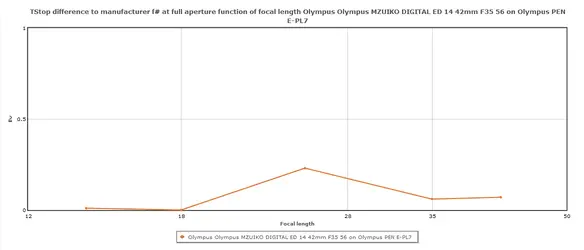

ISO is fixed at 200. Lens mounts perfectly so I looked at T-stops which is something I was not familiar with. Maybe the answer is here:
Olympus M.ZUIKO DIGITAL ED 14-42mm f3.5-5.6 - DxOMark
If I am interpreting the data correctly, this lens has less transmission at 25mm which is the focal lenght I was testing. Is this correct?
The chart shows the nominal F-stop at 25mm as 4.8 and the T-stop is a perfect match (4.8). Ironically, I think 25mm is the only focal length that has a perfect match. But the T-stops reported were all very close to their nominal F-stops, and I would call them "acceptable" performance". I don't know what's going on. . . .
Thanks.
This is the chart (attached) I looked at. I will test again at different focal lengths.
  • Screenshot_2020-01-28 Olympus M ZUIKO DIGITAL ED 14-42mm f3 5-5 6 - DxOMark.webp
