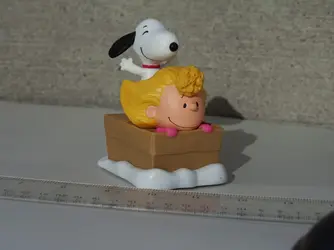

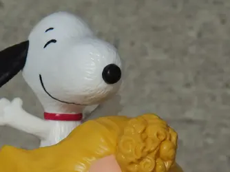

I am uploading a couple of images I took this afternoon on the spur of the moment using my Yi-M1 with its 42.5mm short tele/Macro lens, which, if you can find one (they are sold out at B&H, where I bought mine) costs about $400 US including the lens.

I forgot to mention that the Yi-M1 I used for the above photos is a "Micro 4:3" camera with a smaller sensor than your A300. You have an APS-C sensor. The equivalent lens (to give the same angle of view) would be about 50-55mm. See below for some added comments.
As cheap as this setup is, I can assure you that no camera with a sensor up to around 24MP is going to do better. Other photographers might do a better job, and produce a better picture, but most DSLRs and Mirror-less cameras should be able to handle the task.

Images:
Most of the images were re-edited from the stock JPEG files with NO adjustments (except cropping or resizing).
I also included 1 "detail" crop from from the RAW file which has been modified. Actually, the edited JPEGs are better in this case because I did not spend that much time on the RAW.
"PB240006.JPG"
Partial EXIF
Width 5184
Height 3888
Bit depth 24
Color Representation [AdobeRGB]
F-stop f/7.1
Exposure 1/320 sec.
ISO: 200
Exposure bias: 0 step
Focal length 43mm (42.5)
Max aperture 3.65
Metering mode "Center Weighted Average"
35mm focal length 86
Size 6,337,767 bytes
"PB240006-jpg-rs1640-C1.jpg"
Resized from camera generated JPEG image. "Color representation" has been converted from "AdobeRGB" to "sRGB" by Corel Paintshop Pro, but no other alternations were made to the image.
"PB240006-jpg-Crop01-C1.jpg"
A full resolution detail crop from the original JPEG file of the above image.
"PB240006 -1b-DetailCrop01-C1.jpg"
A full resolution detail crop from the DNG file for the same image. This file has been altered to match the colours and appearance of the JPEG files.

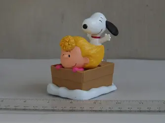

"PB240016.JPG"
Partial EXIF
Width 5184
Height 3888
Bit depth 24
F-stop f/7.1
Exposure 1/400 sec.
ISO: 200
Max aperture 3.65
Size 6,607,326 bytes
"PB240016-jpg-rs1640-C1.jpg"
Same subject but different lighting and background.
"PB240016-jpg-Crop01-C1.jpg"
Detail crop of the above image.

I forgot to mention that the Yi-M1 I used for the above photos is a "Micro 4:3" camera with a smaller sensor than your A300. You have an APS-C sensor. The equivalent lens (to give the same angle of view) would be about 50-55mm. A lens that is about 50mm that does not focus close enough for this picture can be adapted with a "close-up" lens adapter in front of the lens, or "extension tubes" between the lens and the camera body. If extension tubes are bought, special tubes which support the electrical control signals would be easier to use, but more expensive. I do not know the "Raynox 150" that "petrochemist" mentioned, but it sounds about right. . . .
