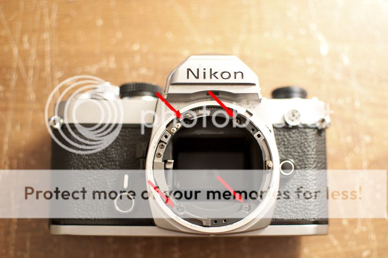

6. Undo the four screws highlighted below. Some FM's have a little tin gasket, this one does not (my black one has the gasket). If you have the little tin gasket, simply lift it off and skip to the next step. If not then undo the following screws.

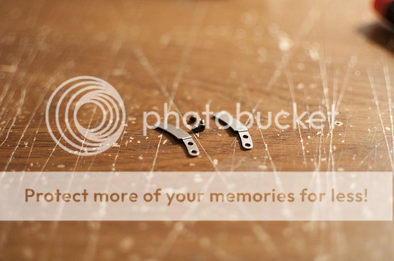

7. Lift these tabs out and set them to the side.
8. Remove the following screws. These hold the metering ring to the body.

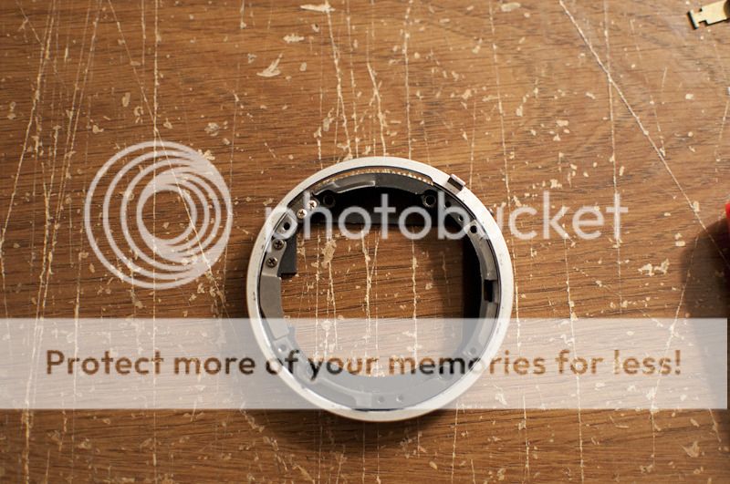

9. Now lift the metering ring out of the body. Also slip the lens locking pin out of the body (the little gold tab at the 3 o'clock position in the previous photo).
10. Set the camera body off to the side and now you have your metering ring.

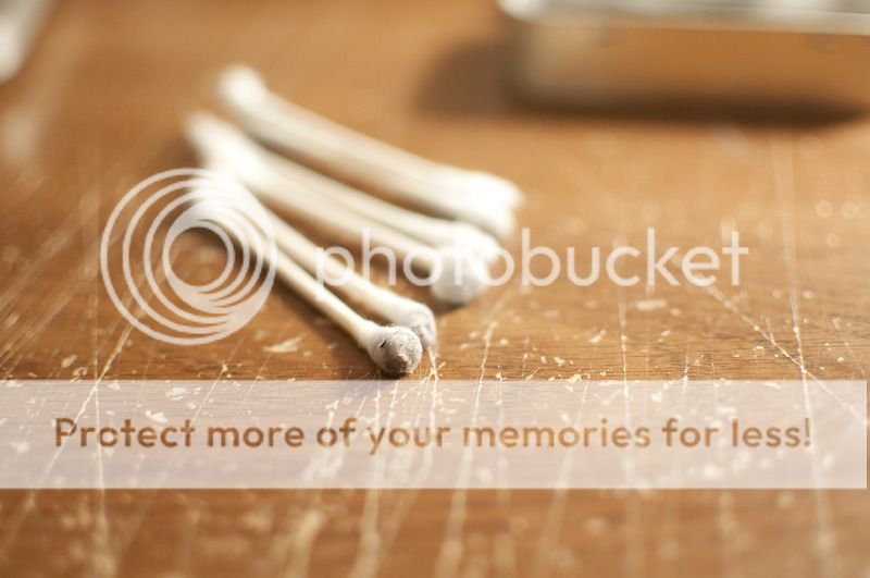

14. Take a bit of rubbing alcohol and use a q-tip to gently clean the dirt off the rings. Make sure you get all the dirt and allow the parts to dry.
15. Some of the dirt I removed. Makes tron_ a very sad man.
