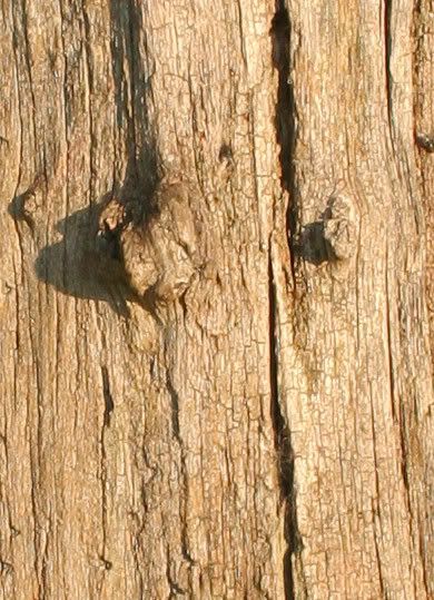

Anyways, a few snaps.
This one isn't too bad. Still sucks in my opnion though, and this is on the better end of the scale. Resized.
and a crop..
A fairly typical, average shot. I'll admit, I could be at fault on a lot of my shots, but still, I have 3 of these and they all look the same. They more than suck.

All modes. But I'm very careful with the point of focus, so I rarely use auto, and if I do I still make sure what I'm focused on. That's what annoys me, when you pay so much attention to the point of being obsessive about it... I have taken pictures on f11, high shutter speed and been sure that I couldn't possibly be out of focus. And yet the results say otherwise.
Jestev said:
The images also look like you moved. It would be easier if you could give us some EXIF information.
Not sure about the EXIF data, but these were all taken on bright sunny days, which is one of the reasons I posted these particular ones. Neither do I have many originals lying about. I would assume around 250th / 500th shutter speed but I can't guaratee that.

True. However, I don't think the lens is focussing properly. A Canon kit lens can't be that bad.
Is there a filter on the lens?
How many megapixels is the point and shoot and how many is the EOS350D. If they are different how about resizing them both to a common denominator to make a comparison. Unless I start spending loads of money on lenses for my D200 the pictures look pretty unsharp when I zoom in at 100% like you did on the tree above.
The P&S probably just applies more sharpening. If you have to sharpen every image then why not setup a batch process. With photoshop you can even save this as an executable.
I've set the cmera back to default settings. I have a UV filter that stays on all the time, I'll try taking that off and giving it a whirl.
