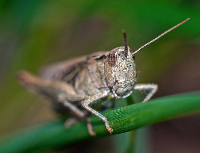

Sunlight is fine, generally...for example...this taken with the 90mm at f8 in the garden last summer...see the narrow DoF even at f8 in the light?
Grasshopper in my garden 4 by http://bendthelight.me.uk, on Flickr
When I was out and about, I used an old flash on a bracket, triggered by the camera. The flash was diffused with part of a plastic milk bottle. :)
But often, my natural light, in the garden, shots have been better. Try to avoid REALLY bright light as hotspots can ruin a generally otherwise well shot macro...diffusion of the light is important.
