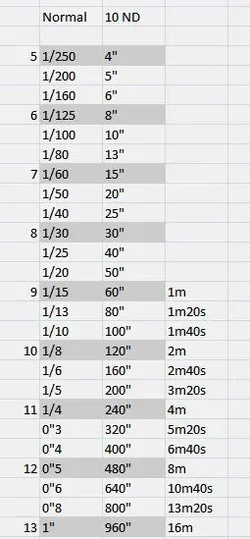

Assuming the filter isn't too much off being a 10-stop filter, as Sparky noted, then the following table should help you.
The left side shows the "normal" exposure without the filter, and the right shows the calculated exposure with the filter.
My technique is to get the exposure I want without the filter first, do the focusing, etc. The ISO should be at base ISO. Then I switch the AF off, the VR/IS off, put on the filter, adjust the time (obviously you do this in manual mode), and take the filtered shot. If the time is longer than one second, the camera (depending on your settings) may also take a third shot following the second to perform long-exposure noise reduction. After all that is done, I check the histogram and see if the image is "correct". Comparing the histo of the shot with the filter and the first one without, should tell you if you need to make adjustments to the calculated ND exposure.
Sometimes, depending on your camera's ability to handle low light, you may just use Live-view and adjust the exposure and focus automatically. However, I find a better result if I follow the first procedure.
