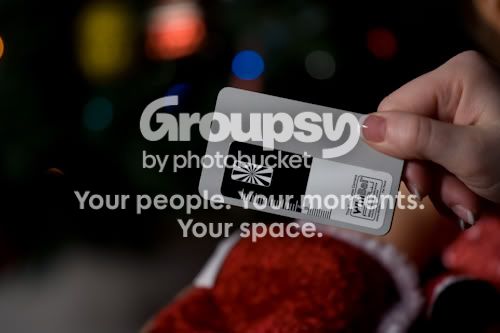

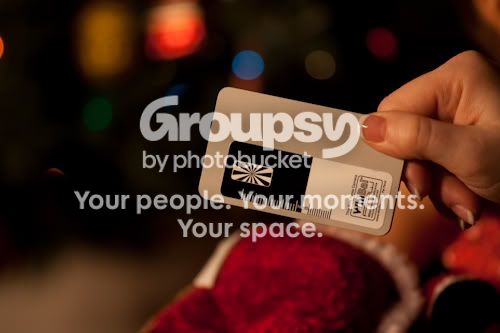

Grey cards are primarily used for exposure...and have been used for decades. Using them for White Balance is rather new because digital cameras have a variable WB. I've used a white card (or white anything) for setting the WB...but never a grey card.
I use a grey card (actually a "WhiBal" card, but pretty much the same) for white balance, works perfect. The only reason (I know of) not to use a white card is that it could get blown out much easier than a grey card, making your white balance reference shot worthless - R, G, & B values would all be 100%. With the grey card you don't run the risk of blowing it out, so those values stay closer to the 50-60% range (depending on exposure, of course).
Here's an example:
"As Shot"
White balance corrected
I just do a "click white balance" on the grey area.

Maybe it's just me, but I see the uncorrected image as having much better color (aside from the card having a beige tint).
Take the card out of the shot and I think most people would prefer the colors of the top photo.
Jon
Jon
I would say, if that is the look you are going for, then there's nothing wrong with having a warmer white balance. That is after all one reason why there are warming filters available and why people like to shoot in the warm light of the golden hour (hour after sunrise/hour before sunset.) But there are times you also want to have an accurate white balance.
What I wonder as I've read about white balance and using these cards that I've been reading for a year is, do you have to be using a RAW converter (such as ACR) to adjust with this method of shooting a white/grey card? I know you can change white balance in Lightroom, but I've only seen a slider and haven't found a way to do it by selecting on a shot such as jeepman there posted. I haven't seen a way to do it in photoshop either. The only thing I've figured in Photoshop was a very poor way of adjusting white balance.
I would like a way to adjust white balance accurately rather than moving a slider to where I think the white balance is correct, but I don't shoot RAW. I am wondering how you can do it with JPEG. Of course, please, no "it's impossible to adjust white balance in JPEG" comments. I adjust white balance and exposure in my JPEGs all the time. I just don't know how to do it with shooting a white/grey card other than using it to do a custom white balance in the camera.
You can use that card with RAW or JPG. In Lightroom (I'm sure Photoshop has it too, I just don't know where it is) there is an eyedropper next to the slider. You just click the dropper, then click the area of the image you want to white balance off of.
You can use any software that has the dropper tool with the WhiBal cards (they make bigger ones too, I just like that credit card size one most of the time).
