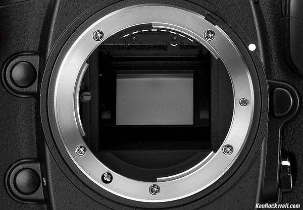

See the little plus shape thingy in the lower right of the lens mount? that turns the screw that focuses a AF lens. The D80 has one, the D40 doesn't.

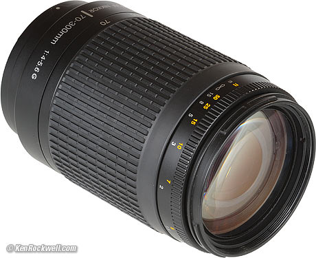

Hmm... Ah, of course, it's a "G" lens. After a bit of searching, I think I've found it. Does the lens look exactly like this one, except silver?
If yes, then it doesn't have an internal focusing motor, and won't autofocus with the D40 (or D40x/D60 for that matter). You can find more info about it on Ken Rockwell's page on the lens HERE.
