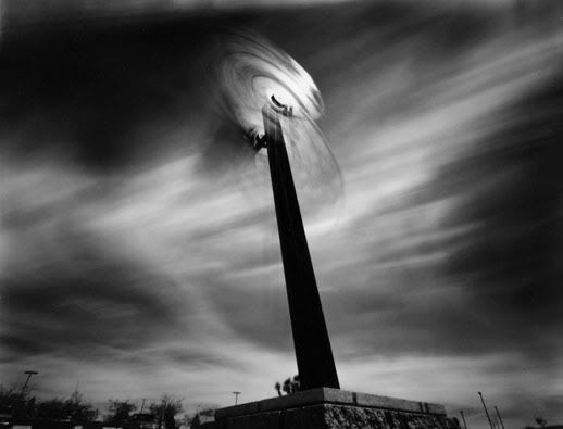

Hey, ST: What you're saying is that there's a whole world of photography out there that isn't digital. And that there's a lot of fun to be had doing it. Very cool idea the English gent had. Now, this is going to seem lightning fast compared to the six months, but I made this pinhole photo with about a 5 or 6 minute exposure on a cloudy rainy day. It's a kinetic sculpture (wind driven two blade propellor) by the artist Steve Rieman. My pinhole camera is an 8x10 4 3/4 inch focal length.

Thanks, guys, for the compliments! And to answer your question...
Back in 1993, I bought a 4x5 inch pinhole camera from the Pinhole Resource as a gift for a photographer friend of mine. He used it with a Polaroid back and immediately got cool stuff. Then, I was envious. So, I bought a 5x7 pinhole camera from the Pinhole Resource (had to be bigger, right? -- no actually, I wanted to make contact prints and I liked that size).
In any case, I loved it, but the camera itself was plain and unattractive. So I showed it to my cabinet maker and asked if he'd build me nicer ones in 5x7 and 8x10. We sent away for the precise size pinholes for 4 3/4 inch focal length from a company that makes them (picture quality will be highest when the pinhole is the right size for the focal length). That was in 1994. He even came up with his own designs that were an improvement on the Resource cameras. Again, you can see them in my "show and tell" under "Alternatives" that I linked above.
So, I guess I've been doing this for 15 years. But the pic above was made in 1996, so it's not like I'm a 15-year expert or anything. I tend to roam from antique cameras, to pinhole, to Holga, to 645, to my workhorse camera for street portraits, The Pentax 6x7. But I recommend everybody try pinhole -- it's really fun!
