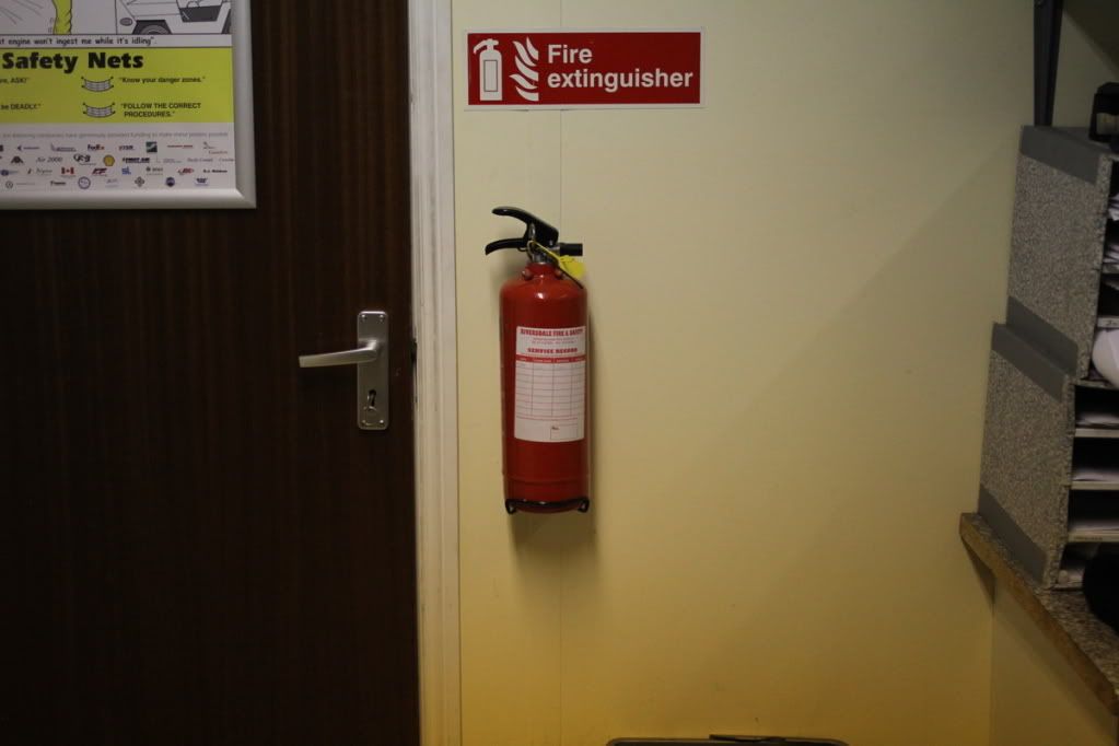

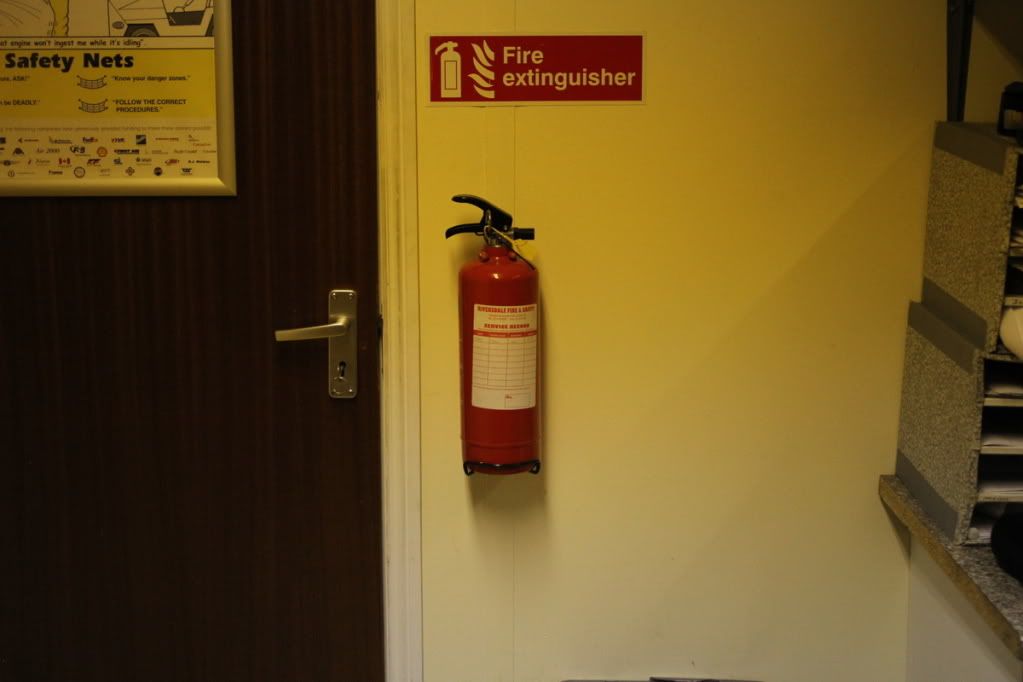

Hi all, I was wondering if anyone could shed some light on a problem I have with my camera. These 4 pictures were taken in a hi speed burst in av mode, all with the same metering and wb setting. They all look different with what looks like a moving colour cast. WB bracketing was not activated so they should all be the same. Any suggestions to solving this appreciated
I'm not an expert, but many kinds of indoor lighting can have variable colour temperatures - our eyes can't see the changes in colour (its too fast) but cameras can and will pick them up. This is why studios use specific kinds of lighting that give a constant light temperature so that the photographer knows what they are working with.
It's cycling lights. You can't see them with the naked eye, but the camera will see them every damn time. It's a PITA when you are shooting in a gym or similar.
I am uncertain, but, I bet you are in a "Auto" WB mode. The camera is seeing different points every millisecond.
Get out of Auto WB and see if the issue stops.

Since these color cycles in certain lights (mostly fluoro's, but also some of the HID type chemical bulbs), are cycling at the same rate as the current feeding them, you can average all the colors of the cycle by using the correct shutter speed. Over here it's 60Hz, but I believe it's 50 on your side of the pond. So if you set your shutter speed to 1/50sec, you get exactly one color cycle, 1/25 gets you exactly two. You can keep going in even stop increments, and your color will be consistent from shot to shot. I'd recommend using manual white balance when doing this however.
I will keep that one in mind. It is 50hz here. I was at very high shutter speed before I got this problem and I was only trying a few things out. For my average day to day shots I don't foresee a problem but its still good to know how to avoid it. Thanks for the input
Problem is then you must use flash if you have anything alive in the scene to stop motion. Most times when you will have this problem you'll be in a gym or similar and for sports your flash isn't even going to be effective to stop motion-most sports there isn't enough flash that will reach your subject to stop any motion. Wrestling is a bit different because you can get pretty darned close to the action, however I don't think that with flash I could use 1/50 shutter speed.
It won't change with a custom white balance either. The camera meters and sees white balance before you press the button, in that millisecond between the cycle can change. I find that I have a problem with about every 6th to 8th shot in a gym being very cyan or gang green looking on subjects. I am not generally shooting a burst or high speed, although it happens from time to time and that changes how many I will have that are really whacked white balance. The whacked ones you can't fix perfectly either and the color temps and tints won't be the same as anything reasonable for the situation.
