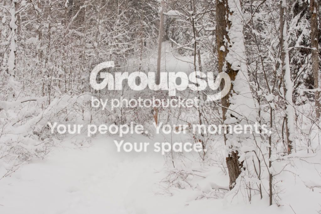

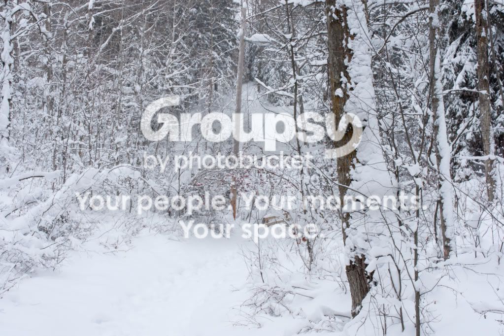

4.I heard people say stay away from f/22, I tried to take a photo at f/22 with my Sony 35mm f/1.8 while trying to manually focus, and I think it looks bad, I don't know if I manually focused wrong (but nothing is in focus it seems and at f/22 shouldn't something be in focus?), or if it is diffraction from the lens because I shot at f/22?
2 different pictures first one was edited in LR, both are manual focus at f/22, 1/20 shutter speed hand held with steady shot on.
You might have to pixel peek to see what I am talking about, look at the tree to the right to see what I am talking about.
Your pictures are in fact soft, but I do not know why. As there are many additional variables that make these pictures hard (snow, overcast), if you have to experiment with manual focus and hyperfocal, I would try with some easier situation.
