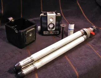

It's been a long time since I've broken Schooner out (so called because she looks like this: )
IMG_2584
by limrodrigues, on Flickr
I've still got some sheets of Harman Direct Positive left, so I think I'll be making some paper positives this weekend.
