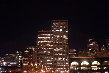

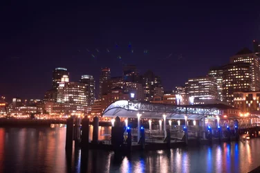

I have Nikon D90 with Nikon 24mm 1:2.8 lens. I took bunch of pictures of a bridge last night, and I got this weird lens flares?
Please see pictures below, and give me advice.
Thank you very much.
If you look at the sky, you can see weird effects.

Lights are showing lens flare....not crispy clear..
Do you have a screw on filter over the front lens element?
Weird? No. Lens flare - Wikipedia, the free encyclopedia
Lens flare is caused by bright light sources that are near to, or in the image frame.
Screw on filters, particularly inexpensive, low quality filters added to the front of a lens add an air gap that promotes reflections (lens flare) in the added gap.
Air gaps internal to the lens can also promote lens flare. However, lens makers (and filter makers) can add coatings that help control lens flare.

What you have here is ghosting not flaring. What lens are you using? You should try another one. Somewhere in the one you used it is reflecting the image on an element which is making a second image, only upside down. I used to have a few lenses back in my film days that would ghost like that on night shots, so I never used them. Now you can clone out the ghosts.
