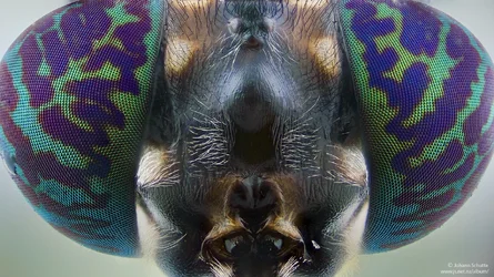

American soldier fly
Jun 17, 2016
69
99
Gisborne, NZ
Canon 70d. Tokina 100mm prime (as Tube lens). Nikon mic objective.
Beauty of a shot! Shame you couldn't get more of the eyes; but really love the result you've got!
i assume you photostacked and the edge of the eyes got lost in the stacking process? In general I find you've got to stack with the frame almost backwards in that hte last frame should be the entire frame you want; whilst hte first should have waste.
Exactly what happened! This was done a year or so ago. Won't make the same mistake again.
