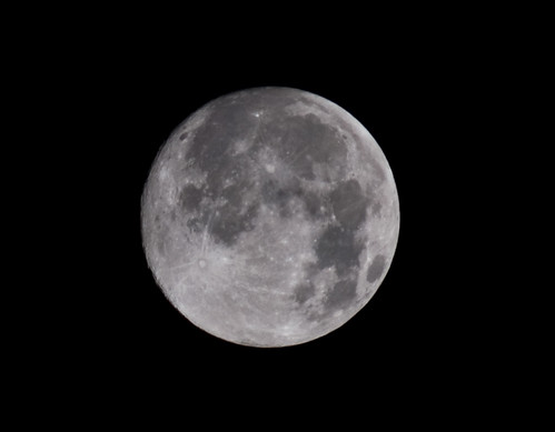

Yep comes down to type deep sky objects? Moon or sky stars and star trails?
As use different focal lengths.
Handheld Moon shot. D90-Nikon 80-200 f2.8 AF-D with Tamron 1.4x.
Iso 200 f5 1/800th handheld. And max crop as at 200-300mm the moon is pretty small in the frame.

October "Harvest Moon" 3 of 3 (Full Crop) by Orbmiser, on Flickr
