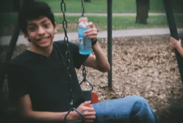

$12.webpThis photo looks like there is a scratch. I'm just not sure wallgreens take much effort in processing film.
Prints don't tell you about the film processing. The negatives do.
I work in a minilab. It is clear that they had a problem. It's a pity but it happens.
Power failures, transporter belts cracking, fake films that use adesive tape(the tape remains in the developer and the films that come after that)... sometimes the tape from the leaders doesn't hold and the films remain in the chemicals forr to long... or a worker didn't apply them well. Aometimes the pumps stop working and you only notice when the chemicals loose much of their qualities...
And this low amount of film processing nowadays makes chemicals stagnate and christalise on transporter spools that aren't sunk in, scratching films or even failing to rotate anymore. Lots of problems, so I recommend not going to a wedding or doing something of big importance on film.
Anyway, you can't do anything now. I am sure they did whatever possible to save it.

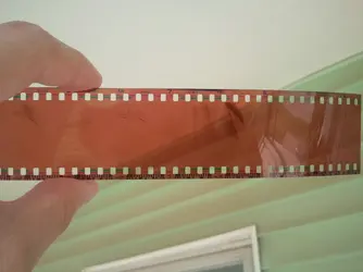

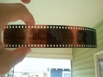

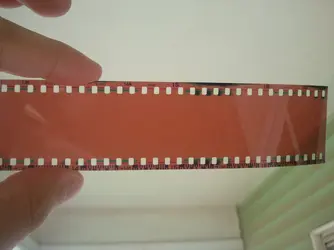

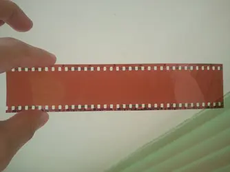

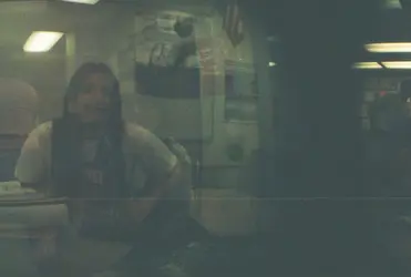

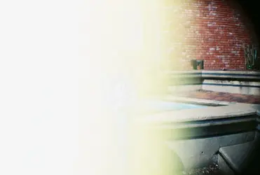

$WP_001101.webp$WP_001102.webp$WP_001103.webp$WP_001104.webp$WP_001105.webp$WP_001106.webp$WP_001107.webp$keeeeeeeeeeeeeeeeeeep.webpHere are some photos of the negatives, along with the photos we got back from Walgreens. We didn't get any prints, we just got them put on a cd, and out of a roll of 24 exposures, we got only these back. As you can see, the rest of the negatives look blank.
Looks like someone opened the camera back before the film was rewound.
There is also a straight scratch (white on print, black on neg) that was caused before the film was developed.
Extreme under-exposure throughout most of the roll possibly caused by faulty shutter or under very low lighting conditions (darker than the classroom) ... or shutter was not tripped (not sure if film can be advanced without tripping shutter on this thing).
Also, for the second-to-last positive image that you posted (the girl sitting at a table), that frame was double-exposed. That is also the frame with pronounced scratches, there might be a problem with the winding system in your camera.
