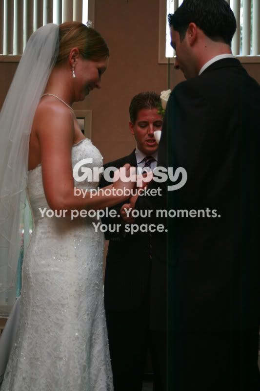

Hey all,
I bought a 5d in May and since then I've noticed some strange banding throughout certain photos. If I'm taking photos indoors and there is a window with daylight coming in, there will most likely be a green horizontal line extending from the window throughout the shot. If I'm shooting outdoors at night, the same thing happens from street lights and such (with a red line). Sometimes indoors the light turns into a green halo if someone is standing in front of the window. What is doing this? And how do I correct it? I've lost a lot of good photos to this anomaly. Any suggestions?
I never had this happen with my old 10d. And I used the same lenses. I'm upgrading to a 24-70 L lens this week so maybe that will fix it? Thanks

<a href="http://s47.photobucket.com/albums/f159/bradracino/?action=view&current=banding.jpg" target="_blank"><img src="http://i47.photobucket.com/albums/f159/bradracino/banding.jpg" border="0" alt="Photobucket"></a>
Here is an image from the last wedding... I couldn't find many more but this is the general problem. In this case it's pretty minimal but it's been much worse in others.

There is a line through the bride as well.
There's actually two going through the bride (easiest to see on her head).

Stage a similar photo, and stop down enough so the windows are not so extremely over exposed. Or better yet, higher shutter speed and slightly more direct flash. Is this with bounce flash? What's it bouncing off of?
The shutter speed of 1/40 at 5.6 ISO 400 of a bright window is going to cause all kinds of stray light bouncing around inside the lens and camera. The windows are at an angle, coming from above, not straight on. I don't know why you are shooting with a flash at 1/40th and strong back lighting?
The CA is an indication of how burned out the top is, and how much bright light is coming from the top of the photo causing internal flare and reflections. The bands match the positions of the blinds on the windows.
Of course, it may be a camera problem, but if you search, you'll find the same problems with many other digital cameras in the same situation. Don't limit the search to just 5D just because that's what you have.
I hate to bring up HP cameras, because hardly anyone here would care, but they had some serious issues with the Sun coming in from the side and you would get a venetian blind effect. Horrible banding! It was only when it was at just the wrong angle. If you search it's often blamed on high ISO, under exposed images. ISO 400 isn't what I'd call high ISO.
It's not just as simple as looking at a couple of photos and saying, blame the camera. There are a number of other factors contributing.
That's not CA. The bands lining up with the window blinds is pure coincidence.
I shoot overexposed windows, sun, off camera flash, etc hitting the lens all the time with my 5D. He's got a problem with the camera.
