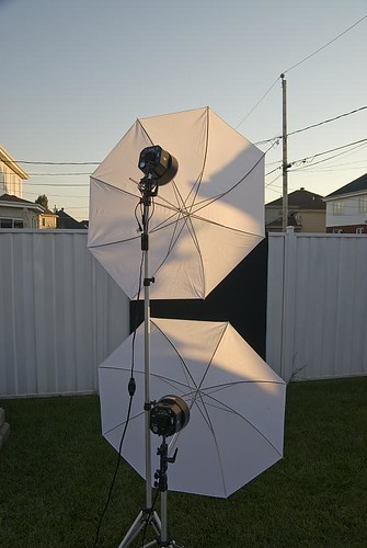

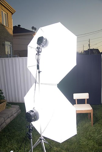

If you want the look of a 3 X 6 foot softbox, the clam shell method with 2 umbrellas is uber-easy to setup and is almost impossible to get a bad shot with:
Just make sure that the bottom light is 2-4 stops lower than the upper light!
