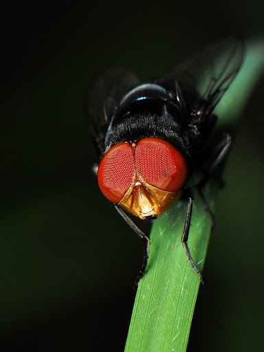

I love the big eyes on this fly. It's no wonder why these guys always seem to see you coming!
They grow em big in Ozland! That or you've been cropping to help show off those fantastic eyes again! I've never manged to get a fly shot at 1:1 to show eye detail when cut down to websize unless I cropped it away.

Hi
Yes it's no secret that I will crop for composition and to bring out finer details like the eyes, but only a super sharp shot with good diffused lighting will allow me to do so. If there is any hint of motion blur, cropping is going to reveal these faults even more.
Have I thought of using teleconverters? Yes, it is definitely something I'm looking into soon and the ideal magnification I'm looking for. I just want to make sure I get a good quality one, as it would be a real shame to turn my nice sharp 105-mm into the optical equivalent of a coke bottle! I can't use extension tubes with the 105 mm so a teleconverter is the next option and I want to ideally get some good glass.
