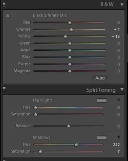

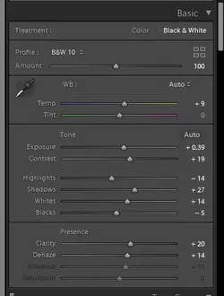

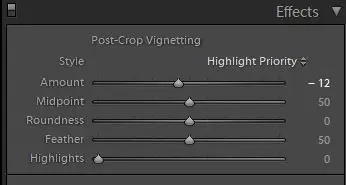

Echoing Derrel's comment above it's muddy. One thing to remember on a B&W conversion, is that a "good" properly exposed and processed color shot will yield a "good" B&W conversion. You always have more options in processing when you have a full data file. Your image shows almost a 1/2 stop underexposed. When you're underexposed it's hard to get the whites to pop, and the midtones clean. Also, even though it's a B&W WB still affects the crispness of the image. Here's some of the changes I made in LR to show the effect.
And the result of these adjustments.
