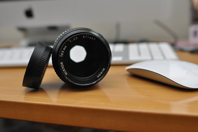

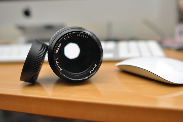

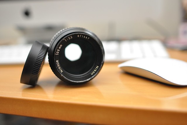

I started to notice that when using medium to small apertures (around f/9) that my photos would be overexposed. The smaller the aperture, the more overexposed the image seemed to be. No matter what mode I was shooting in...
When I noticed this, I tried all three lenses I owned at the time. All three had similar results. I've recently acquired two new (used) lenses and I've ran some tests. This is what I've found:
  • On my 50mm 1.8, the aperture blades do no stay fully open when resting. The aperture ring is locked to its smallest setting (22). My guess is it's not letting in the proper amount of light and thus the camera is metering wrong. When the camera is set to 1.8 and the DOF preview button is pressed, it gets a tad bit smaller than its resting spot. Which, again, is not full open. It physically stops getting smaller when the camera is to 5.6.
  • On my Sigma 28mm 1.8, the blades sit wide open, but just like the nifty fifty, the aperture doesn't get physically smaller in the lens then 5.6 in DOF preview mode.
  • I bought a used Nikkor 70-300mm 5.6G for real cheap. Interestingly, it doesn't seem to affected. Shooting tests and DOF preview test work as they should.
  • Also, I just got an old Nikkor 105mm AI. Since I have to control the AF and aperture manually and it does not use the aperture lever in the camera, it works just fine.
  • The aperture lever does not look bent or distorted. Although the tip looks a little jagged, I cannot tell if that's normal without another one to compare it to.
Below are some shots I took. In all the photos, the settings were the same except the aperture. I think you'll notice after f/5.6, the photos do no change exposure-wise. Histogram seems to confirm this.

So it seems the aperture lever is not pushing the levers on the lenses properly.
