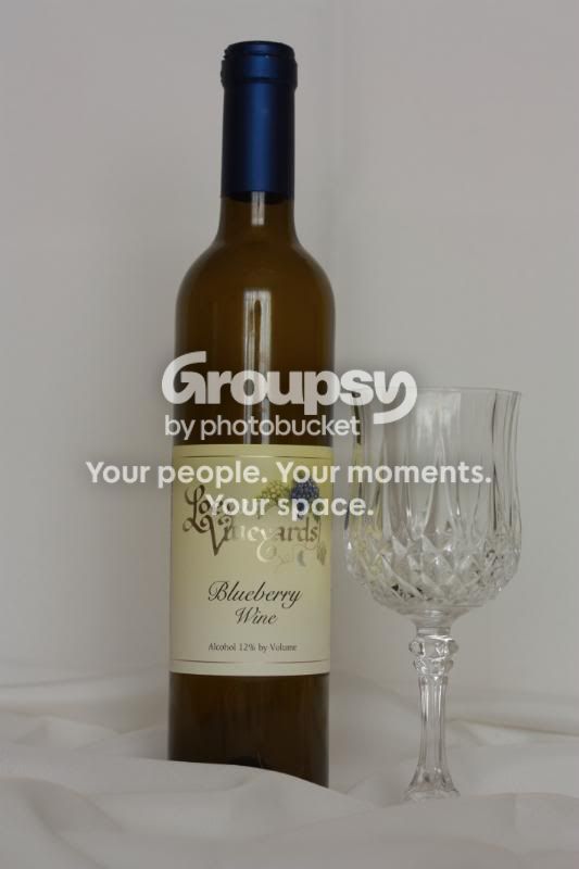

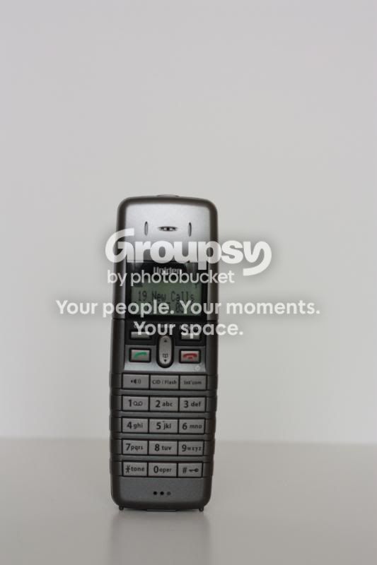

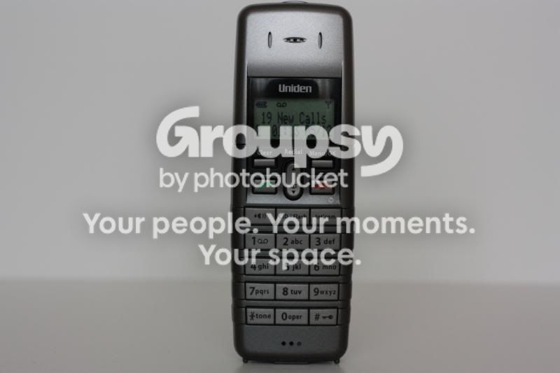

I know these pictures are not "interesting"...
I made sure there was no bad cropping (IMO at least), I did the custom white balance (although it still seems kind of off to me...), I used the metering (made sure the bar was under the 0) and they all still seem a bit underexposed to me... What am I doing wrong? :(
The white balance looks good.
The problem with your metering is that you are probably using scene evaluative which is going to underexpose because of the white background takes up a majority of the scene. Snow will have the same affect. To assure proper exposure on the single subject, use spot metering and take the reading off the phone/wine bottle. Take care not to meter a reflective part of the phone...try to find a part that seems "neutral" in brightness, like the keypad of the phone, and the label of the bottle.
Or you can compensate for the white background and "overexpose" according to the evaluative metering.

Nah, I didn't say you sucked. It's just a technical issue that you weren't aware of.

Remember, the info I gave you was very basic. Metering get's more complicated, but at least you are starting to think about it. Step by step you will learn more about how to meter, what to meter, when to do different than what the meter says, etc.

Well, I wouldn't go that far. :lmao: I just said your white balance looked correct. Add some creative light to these exact same setups you have and I think you'll see the quality of the shots go WAY up. As they are, they are 'boringly' lit and underexposed.
I think technically, the telephone photos need more light coming from the front. On the wine bottle, I do not like the tall, black outline that shows up in the middle of the catchlight. The "break" in the catchlight from the top of the bottle to the neck of the bottle is a bit disconcerting, and the bottom of the bottle loses the catchlight as well, so it does not look like a professional photo. But please do not be discouraged--these are some of your very earliest sample efforts in an entirely new area of photography for you!
