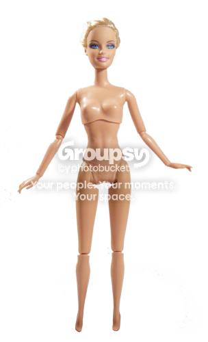

Here is a composite of two photos (upper and lower body), and I can sense that something has gone awry with her proportions (aside from the fact that she's Barbie), and the lighting is too harsh for my liking and kind of all over the place:
The original size is about 4000 pixels wide, but even so the face is far too blurry for editing, and I'd like to have as little shading as possible on the face. Ideally, I won't have to take an upper-body and lower-body shot, but instead, one clear shot of the entire doll.
We can't tell what you are doing without seeing the full image.
You've uploaded a tiny one without any of teh image data attached.
Please upload and link to a fullsize picture.

I think photobucket would just resize the image anyways, but I try:

To best do that you should first explain/show us your current lighting setup.
Sounds like you missed the focus when taking the photo in the first place.

My lighting setup is hilarious. It's just two house lamps with like, 100 watt bulbs. Though really. Trust meh, I need more crisp detail from the photos, and I really am convinced this camera will not offer them, no matter how good the lighting setup.
A decent camera (Do not has to be expensive) and good lighting should be able to improve the result.
You may notice the shadow of the better photo is quite soft and it does not have hot spots (super bright spot), that must be the result of a diffused light. Google "diy lightbox" and see some examples. With a lightbox or light tent, you should see some improvement. Since you are using continuous light, it is better to mount the camera on a tripod. (if you do not have a tripod, at least use a bean bag)
